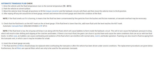

Got towed. Turns on no Issues. Will not move in any gear with given gas. Returning back to park, you hear a metal broken up sound. Before this, when you start moving it would rev some but not hold the car back. So I would take my time taking off, not heavy footing. Is it the transmission?

We can help with that. it sounds like transmission issues. have you performed any service or repair prior to issue? proceed to scan for codes, (see link below)
Second perform fluid level check (see diagram below).
In your case you will not drive but only start and check fluid level.

Okay. Thank you. The check engine was on then it would go off. I tried to get the code but it didn't return anything.
