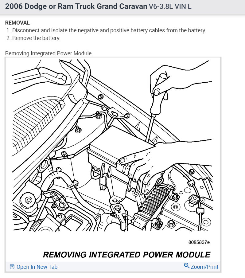

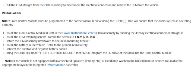

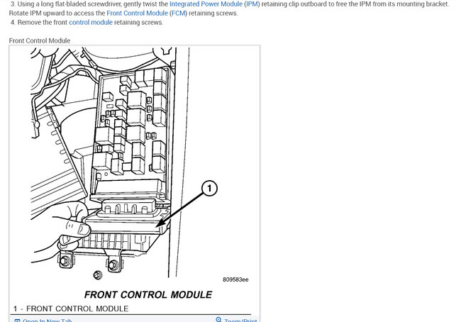

Yes, the fact that it got wet is not good, the TIPM is a delicate part which goes out frequently. To be sure you should do a CAN scan which may show codes to help point to TIPM failure. You can get a CAN scanner (Controller Area Network) which will work on most cars from Amazon.
https://youtu.be/u-4syLc-ifQ
Here is how to replace the TIPM which is easy because it self-programs itself. Check out the images (below). Please let us know what happens.
Oct 31, 2023 at 5:15 AM
