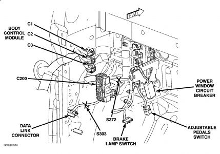

The lights on the dash flicker. Sometimes the radio turns off for a brief time then turns back on. We have been told by Dodge thaat one or the other of the above is the problem and the Intelligent Power Module is on backorder to the tune of 500 items. This sounds pretty f)*^%^ up to me. Anything you can provide will be of help to us in choosing a path of action.

If the BCM need to be replaced (and its very common on the Chrysler product and specially the vans ) then it has to be replaced some times disconnecting the BCM and waiting few minutes and then reconnecting it may reset the software and get it working for you located behind left side of dash
https://images.2carpros.com/forum/automotive_pictures/99387_Graphic1_644.jpg
good luck
