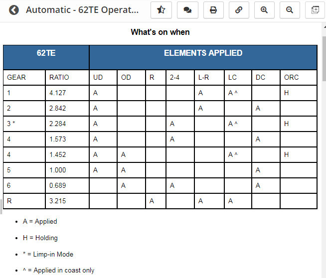

Okay. More than likely this is inside the transmission. The low/reverse clutch is applied in reverse and first and is most likely your issue. However, this is a 62TE transmission and they are pretty cheap to replace. They have been around since the 1990's so most shops can rebuild them also pretty easily.
If you have not changed the fluid in a while, you can try this but it sounds like it is just beginning to wear out.
If it were me and being familiar with these 62TE units, I would change the fluid and then just keep driving it until it is missing shifts or slipping/banging and then rebuild it.

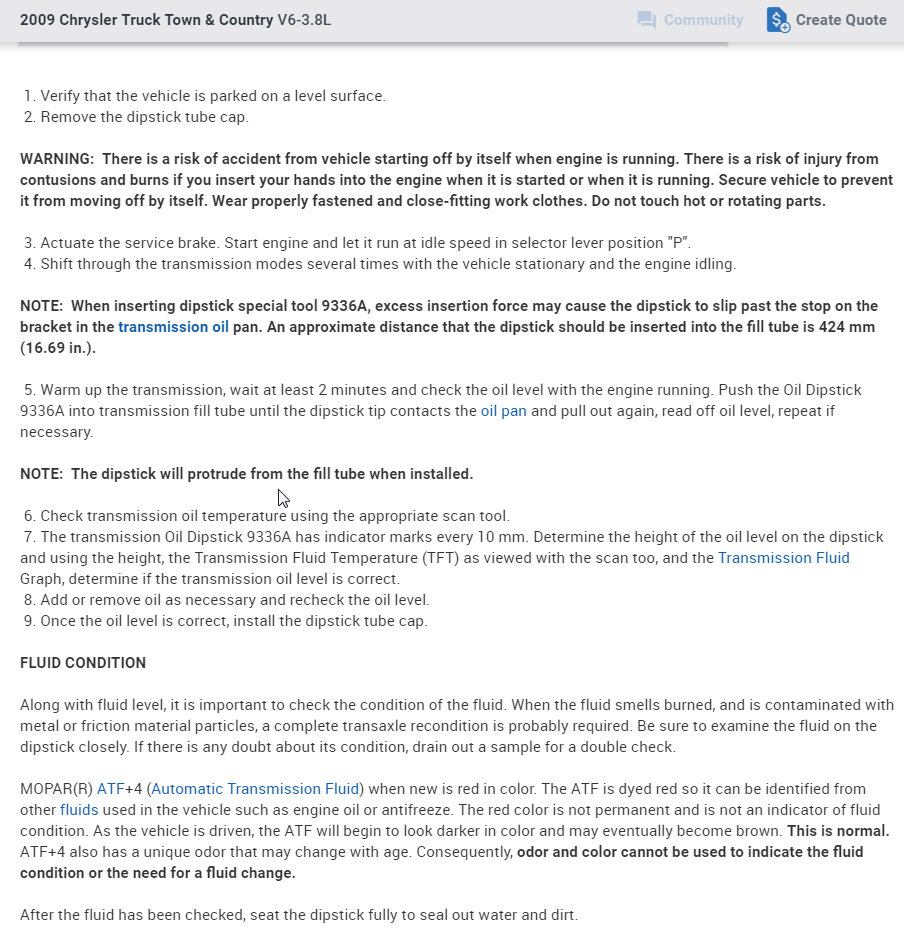

I really can’t change the fluid or filter because there’s no dip stick and I don’t have the tools to check for the proper fluid level. so I guess I’ll drive it until it drops.,I’m just trying to save money since I’m on social security and don’t have much, I’ve gotten estimates ranging from $1,200.00 to $2,000.00 for another transmission. guess I’ll have to save up.
Thanks for the help.
Jun 29, 2019 at 1:20 PM
I understand. However, if you have a 62TE transmission then you should have a dipstick. I am not aware of any other transmission options on a 3.8L Town and Country so here is the procedure on how to check it.
Let me know if you need anything else. Thanks
Jun 30, 2019 at 1:47 AM
DENNIS HAZARD
  • 22 POSTS
It does have a dip stick tube, but I don’t have the special dip stick or the scan tool to check the correct temperature.
Jun 30, 2019 at 5:41 AM
Sorry. I take that for granted. You are correct. It may be worth to just have the fluid checked. Most transmission shops will check it for pretty cheap if not for free.
