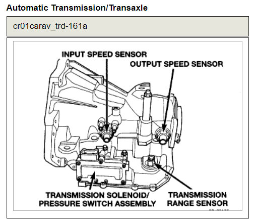

2001 Chrysler Town and Country 6 cyl Front Wheel Drive Automatic 80.000 miles
car selectes forword gears but no reverse, fluid is clean and now noise.

This sounds like you have a gear range selector sensor that is out. Here is a guide to help you remove the the sensor and replace it
Here is the location on your transmission

Read codes, po700, p1782, po732, po734, po736, I have stall speed in all gears including reverse it drives in d looses drive in 2, stop engine and have d and l but no reverse

Those have a lot of transmission codes there it sounds like you need a rebuild.

That's what I had to do for the tune of $1100.00 but hey!@ The car is running again
