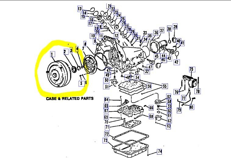

Truck starts but when I put it in gear it shuts off.
Saturday, April 20th, 2019 AT 7:10 AM
  • 52,797 POSTS
Good morning,
Does it shut off in reverse as well?
If it does, the torque converter is locked up causing it to stall.
If it does not, it could be a seized clutch pack in the transmission.

19. Remove torque converter housing cover attaching bolts, then the cover.
20. Using a piece of chalk or equivalent, mark flywheel and torque converter from assembly alignment.
21. Support engine assembly using a suitable jack.
22. Remove flywheel to torque converter attaching bolts.
23. Remove transmission bellhousing to engine block attaching bolts. Note positions of any brackets or clips for assembly.
24. Slowly and carefully slide transmission assembly rearward, off locating pins, then install torque converter holding fixture tool No. J-21366 or equivalent.
25. Reverse procedure to install. Tighten torque converter attaching bolts. Torque transmission to engine attaching bolts to 35 ft. lbs.
