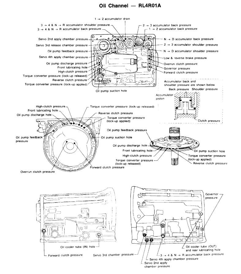

I checked the dipstick for any metal flakes i didn't see any. I'm going to drop the pan tomorrow and see if by any stroke of luck i can see if something is in it that might give an indication of what failed. if not i will probably go ahead and put in a new torque converter and hope for the best. If that's not the culprit then the fun part begins. I appropriate the feedback.
May 7, 2020 at 10:23 AM
STEVE W.
  • 15,351 POSTS

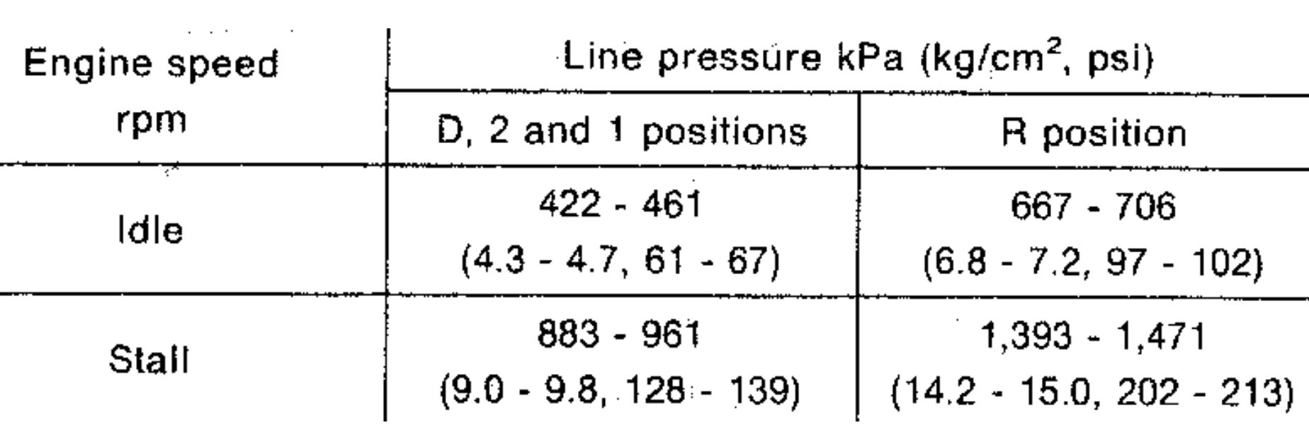

If you don't see any metal in the pan it likely isn't the converter, Normally they leave some metal in the fluid if they chew themselves up same with the front pump. You could try running a pressure test on it to see if the pump is turning and if any of them respond when you shift it. Zero pressure would mean the pump isn't turning low would point at internal leakage.
