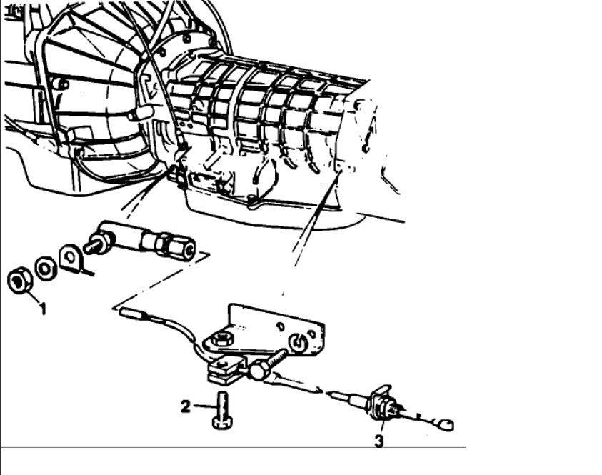

Any one know why my 89 xj6 has no reverse it dent matter where I put thevshifter on the J type shiftier its all forward yes its a automatic.please help my brothers.I noticed it has a trans relay undervglove box could it be that
Mar 10, 2021 at 7:05 PM (Merged)
  • 54,837 POSTS
It sounds like you have shift cable or mount on the transmission that has become loose. You must start by lifting the car Here is a guide so you can do that safely.

  • 5 POSTS
Well I got it to go into reverse but not drive slips I readjust linkage it was off bubbled check it so is the drive belts bad now or can they be righted on a jag tranny
  • 54,837 POSTS
I don't believe the bands can be tightened it sounds like you need a rebuild
