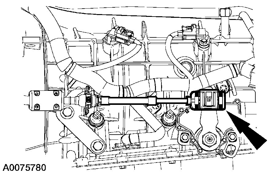

Transmission will not engage and code P0503
2004 MERCURY MOUNTAINEER
225,000 MILES • 4.0L • 6 CYL • 4WD • AUTOMATIC
VALERIE MILLER
Vehicle will try to engage in gear, but wines like a possible sensor. no R,D, or 321 and when put in park it will still rolls like it's in neutral. code I got P0503. could the WSS cause this issue?
May 13, 2020 at 5:05 PM
  • 110,194 POSTS
The code is related to the transmission control circuit. However, it sounds more like a linkage issue or the range sensor is bad.
Tell me, You said, "No R, D, or 321." Do you mean the indicators don't light up? Is it staying in P only?
Also, the shift lever linkage is adjustable. It could even be disconnected at the transmission. I attached a pic of the linkage on the trans. Make sure it is connected and tight.
Let me know what you find and also, let me know if you checked the fluid.
