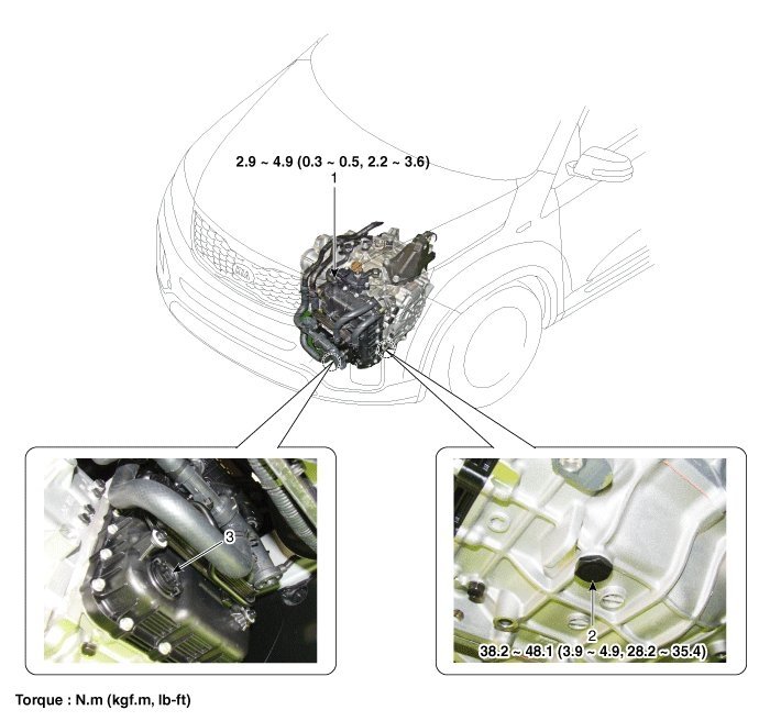

When car is cold, it shifts fine. But when the car is warmed up, if I start from, park, to drive, the car will jerk, then go. Sometimes going from park, to reverse will do it too.

The first question I have is this. Has the transmission fluid ever been changed? Have you checked fluid level and condition?
Also, is the check engine light staying on when the engine is running?
What I suggest first is to confirm the transmission fluid is full and clean. To check the fluid level, the engine needs to be running and at operating temperature. You will remove the fill plug on the transmission (oil level). Fluid should trickle out if it is fill. If nothing comes out, you need to top off the fluid level until it begins coming out. Take a look at pictures 1 and 2. They show both the drain and fill plugs. You want to remove the fill plug to check this.
If the fluid is extremely low or dirty, you really should drain and refill it. Here are the directions for that. Also, the start of the directions indicate how to add fluid if it is low. The remaining pictures correlate with these directions.

1. Remove the ATF Injection hole(eyebolt) (A).
CAUTION:
Always replace the O-Ring (A) of the eyebolt use new one whenever loosening eyebolt.
2. Add ATF SP-IV 700cc to the ATF injection hole.
3. Start the engine. (Don't step on brake and accelerator simultaneously.
4. Confirm that the temperature of the A/T oil temperature sensor is 50 - 60 C (122 - 140 F) with the GDS.
5. Shift the select lever slowly from "P" to "D", then "D" to "P" and repeat one more at idle.
CAUTION:
Stop in each gear position for 3 seconds.
6. Lift the vehicle, then remove the oil level plug (A) from the valve body cover.
CAUTION:
At this time, the vehicle must be a horizontal state.
7. If the oil flows out of the overflow plug in thin steady stream, the oil level is correct.
Then finish the procedure and tighten the oil plug.

1. Remove the drain plug (A) and reinstall the drain plug after draining ATF totally.
Drain plug tightening torque :
38.2 - 48.1 N.m (3.9 - 4.9 kgf.m, 28.2 - 35.4 lb-ft)
CAUTION:
Replace the gasket before reinstalling the drain plug.
2. Fill the oil about 5 liters.
3. Check the oil level.
