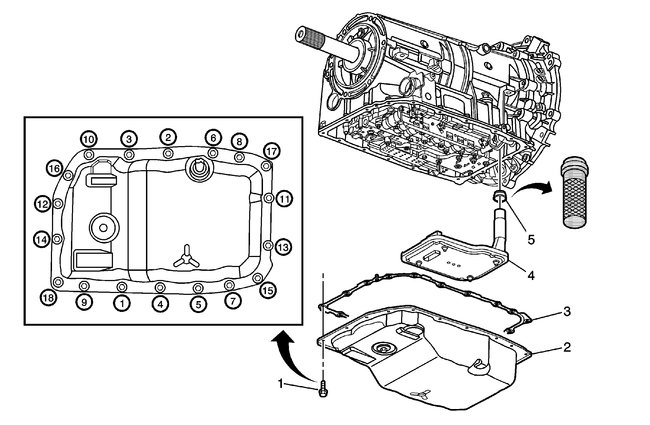

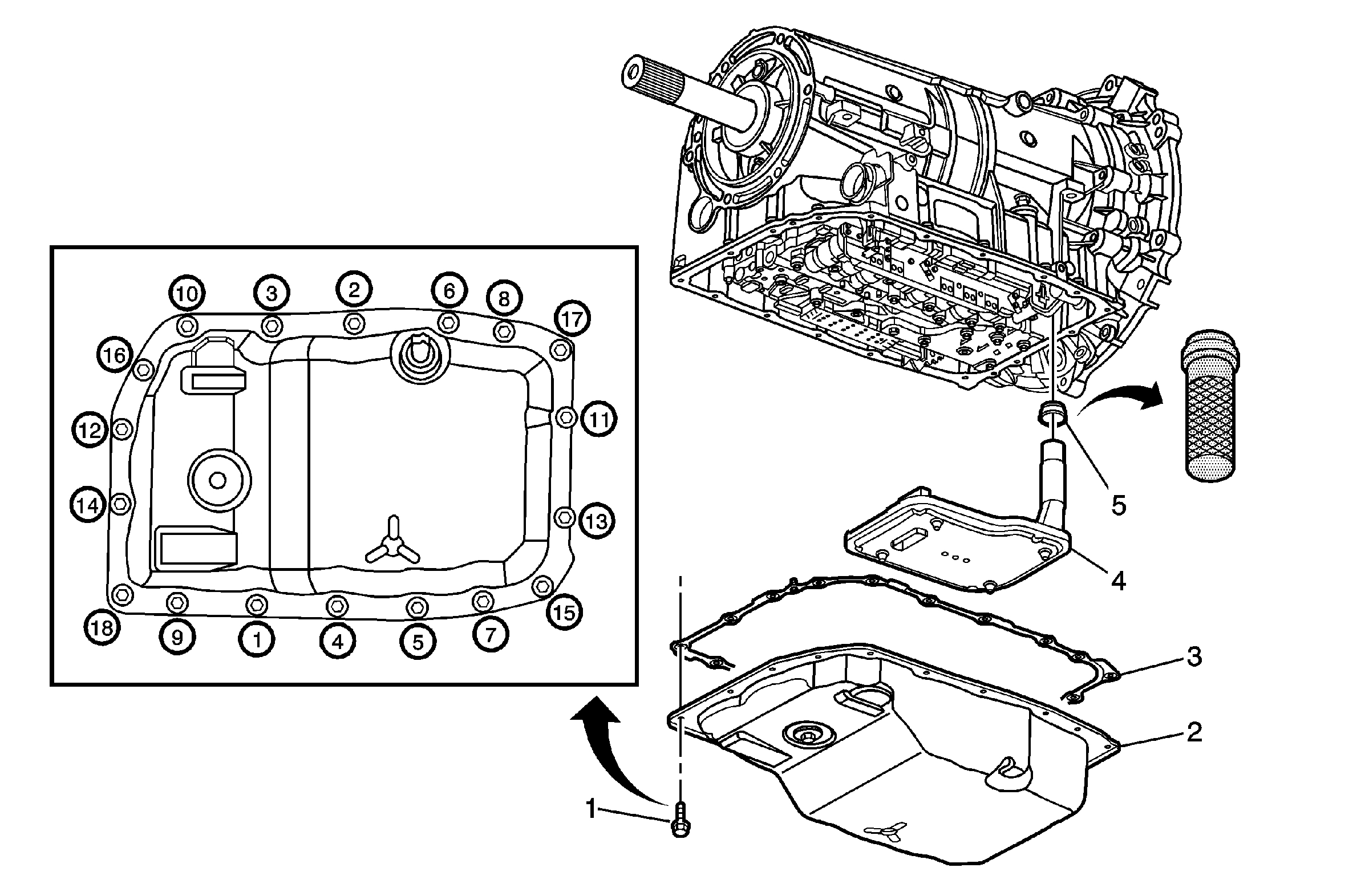

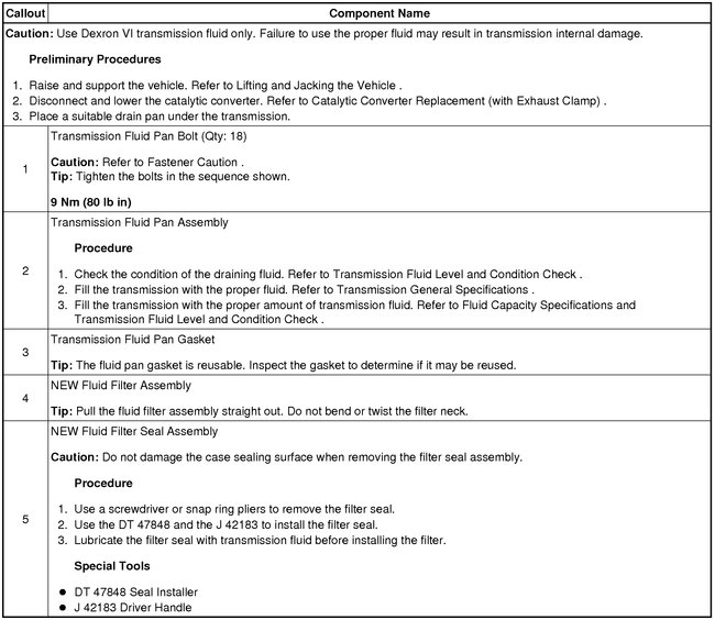

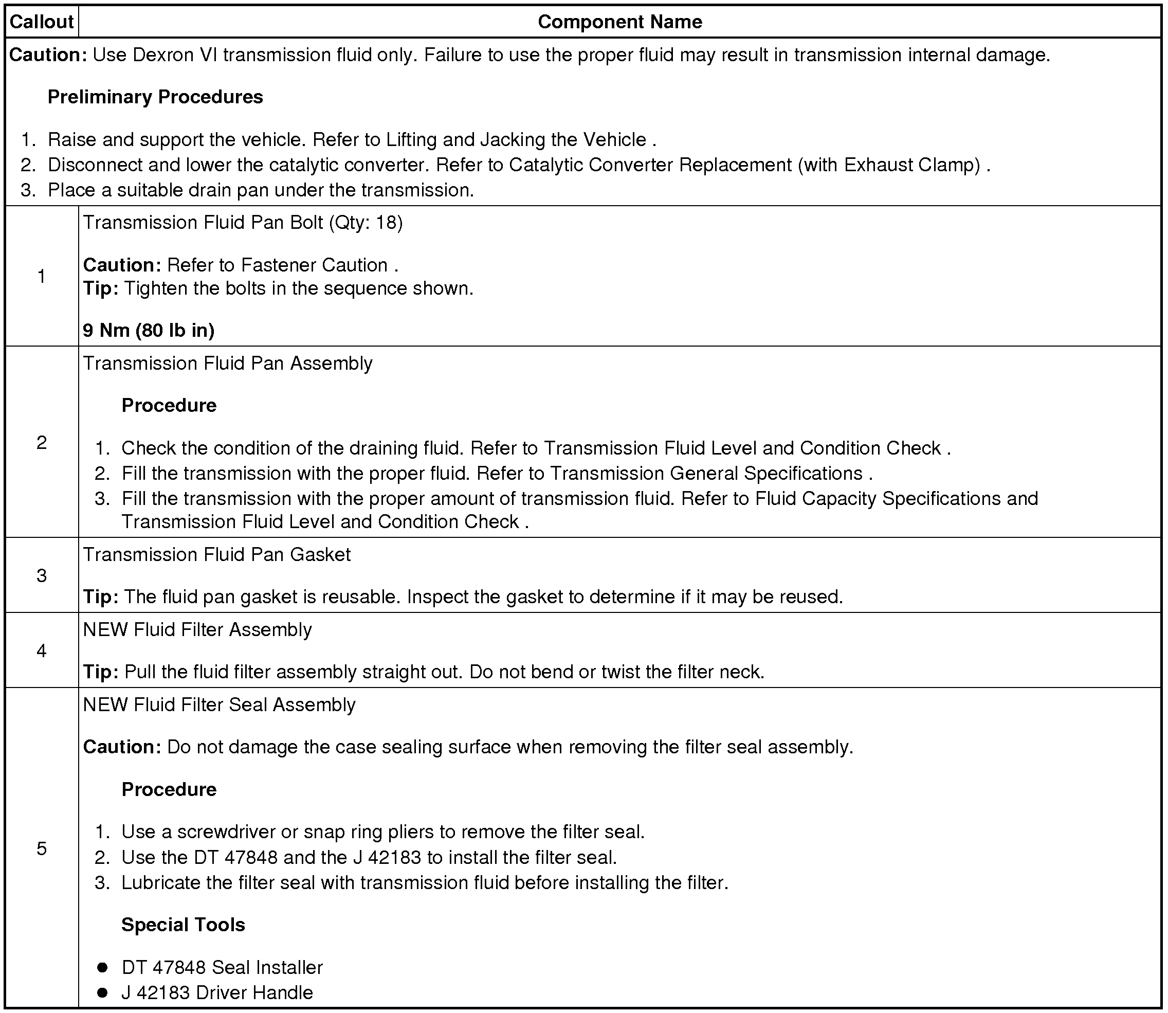

The directions specific to your vehicle are in pics 1 and 2. Please note, if you replace the filter, there is a rubber grommet where the filter pushes into the valve body. Make sure to remove the old one and install the new one. If you forget and both are used, the trans will not work because it will leak at that point.
