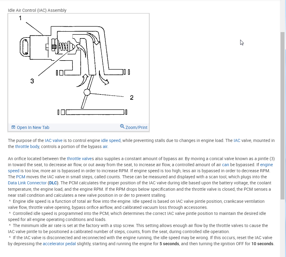

The way to try and confirm an IAC on this engine is to hold the accelerator open just a touch when this happens.
As you can see from the attachment, the IAC just bypasses the throttle blade to control air flow. So if this is the issue and the IAC is sticking closed not allowing enough air into the engine then cracking the throttle will correct this.
You could be onto something with this because I initially discounted this because you said you cleaned it and that usually at least make a change to the issue. However, re-reading your issue that it is fine when you hold the accelerator seems to prove this out. Clearly it is not definitive but if it were me, I would replace the IAC based on this info.

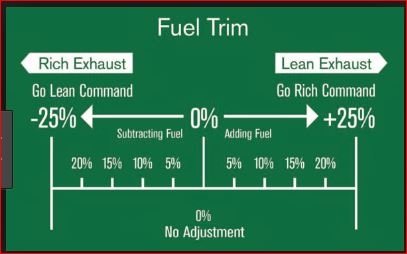

Okay. Do you have easy access to that scan tool from your friend? If so, we need to monitor a couple things. We need to look at o2 data when it is stalling or getting ready to stall. We need to see if it is going lean when stalling. Either look at the short term fuel trims or o2 voltage.
Also, here is a guide that will run through the other common causes. Let me know which of these we have not addressed and we can chase that down when we see what the o2 sensors are reading when it is stalling. Thanks

I had another shop try to figure it out and they said my whole right side was really working and it was struggling to stay alive. So it took it to a shop to see if they could fix it. The said it was my fuel pump or fuel pressure regulator. So I pulled the pump even though it was already brand new and replaced it. And replaced the fuel pressure regulator. But when I was doing that I noticed the boot that goes to the fuel pressure regulator witch is also a vacuum hose has a slice in it.. Do you think that could be the problem? I'm going to replace it anyways but was just curious. If that could be what's making my pressure drop. And making it fuel/ air ratio bad.. The mechanic said when they turn the Pump on then off it dropped like 5 psi per 2 secs. I've spent son much money trying to fix this I'm at my ends with it. Lol. And no sorry I have no access to that scan tool.
Monday, March 23rd, 2020 AT 1:33 PM
I am not sure I know which line you are talking about however, if it is a vacuum line and not just a vent line then it can definitely be an issue. At least it is not something that we want to ignore. Maybe get a picture of it and that will help.
Also, the fuel pressure dropping that quickly doesn't sound normal so I am sure you are on the right path.
