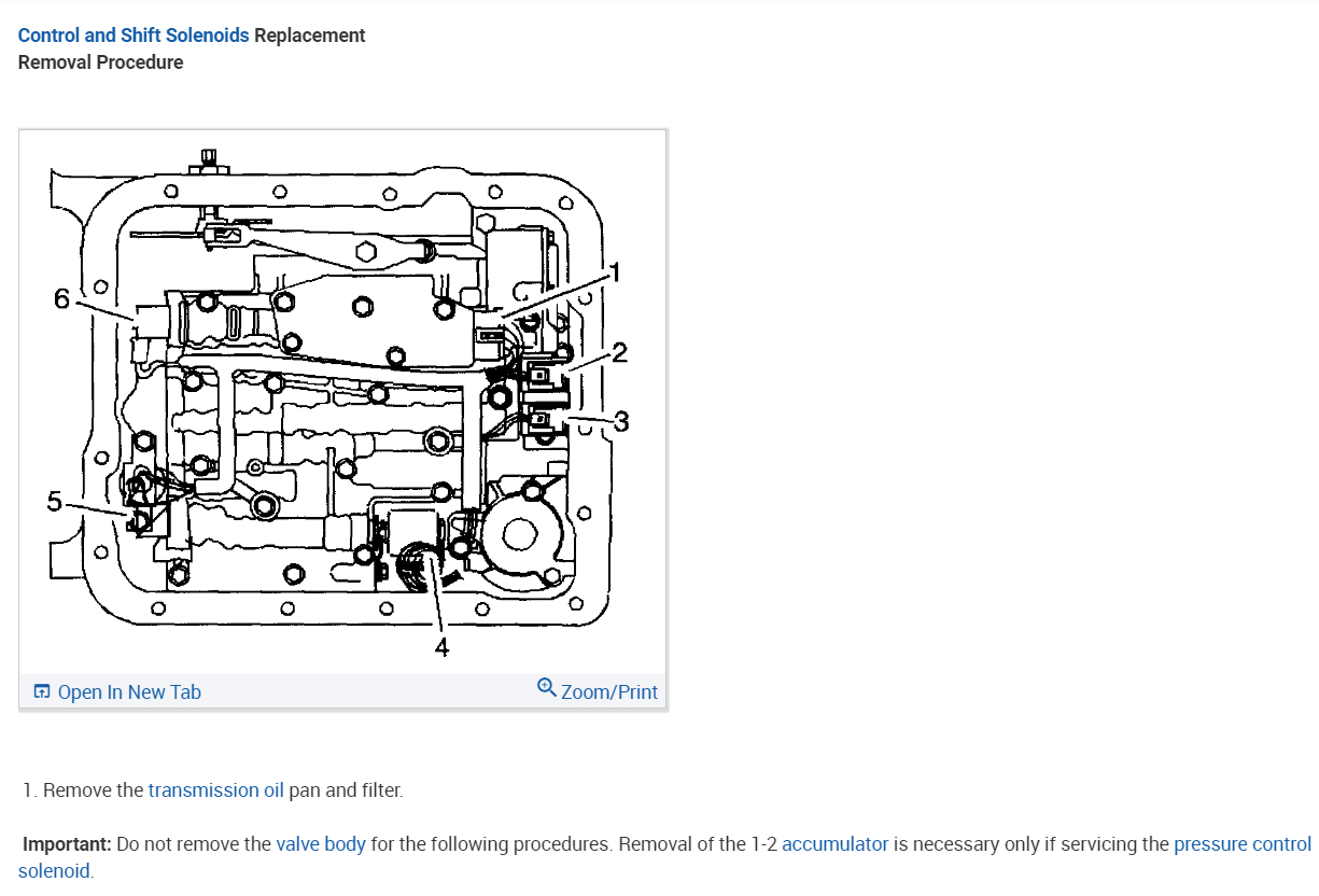

transmission, only drives in reverse gear?
180,000 MILES • 5.3L • V8 • 4WD • AUTOMATIC
PAUL SUMMERS

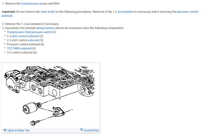

all forward gears are zero fluid is good not burnt. was driving fine then nada.
Jun 23, 2023 at 5:36 PM
  • 55,456 POSTS

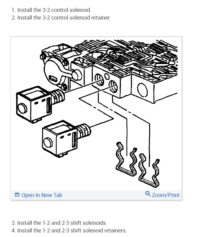

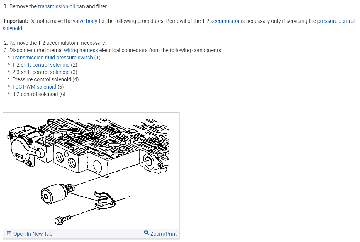

Are the gear inductor lights working, okay? If not, you have a gear range sensor that is out. We should run the codes to see what comes up, this guide can help:

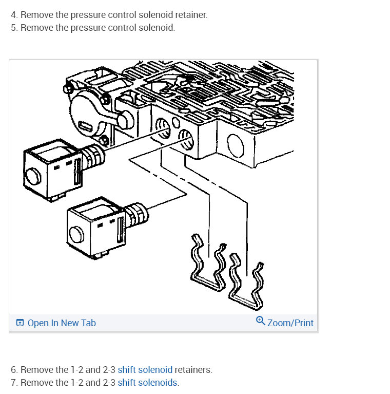

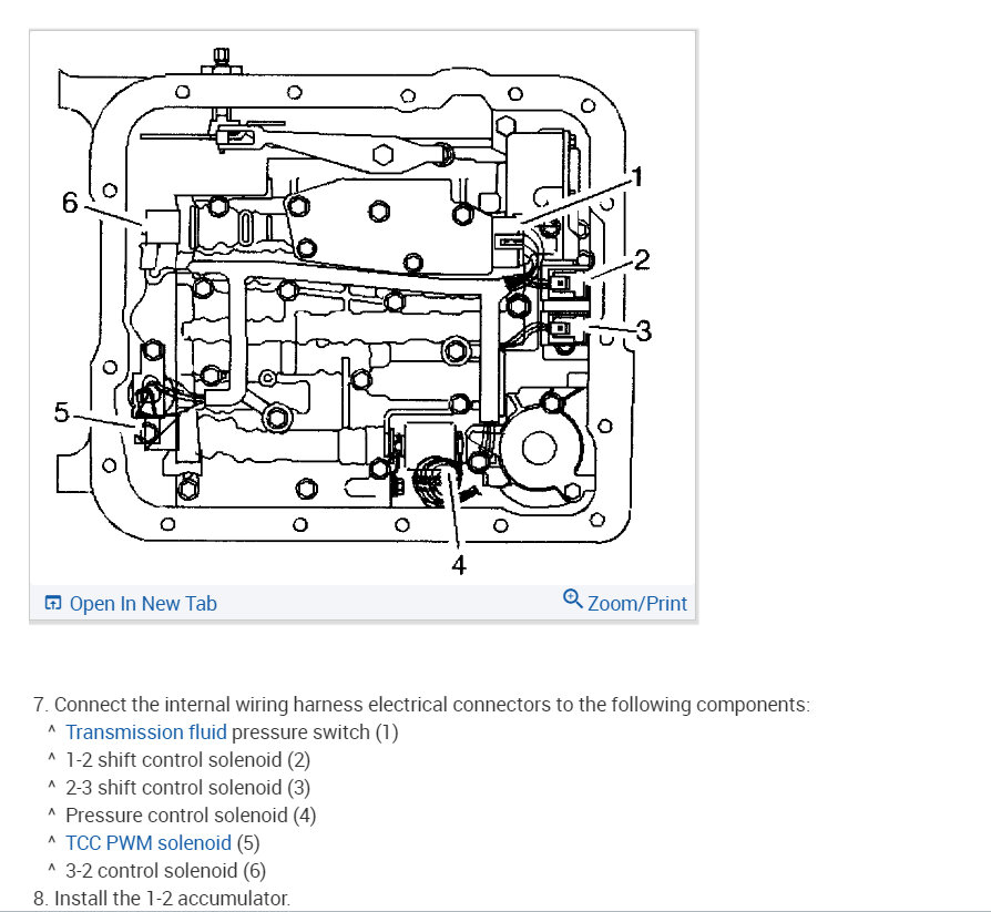

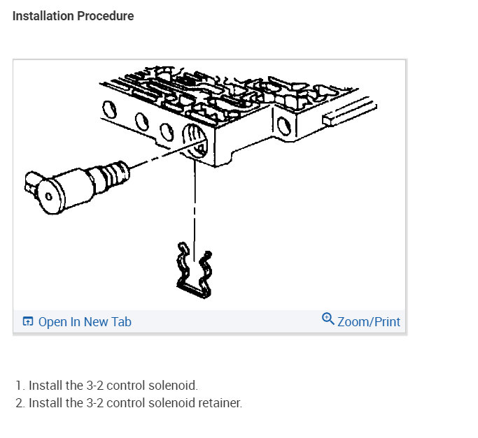

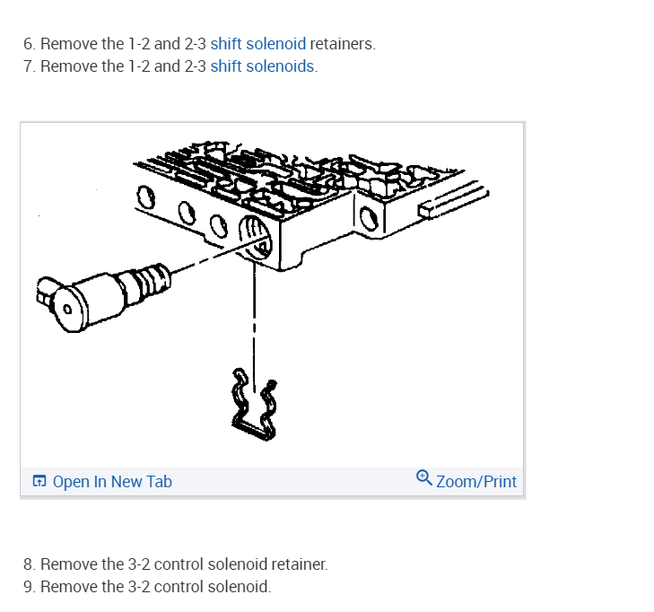

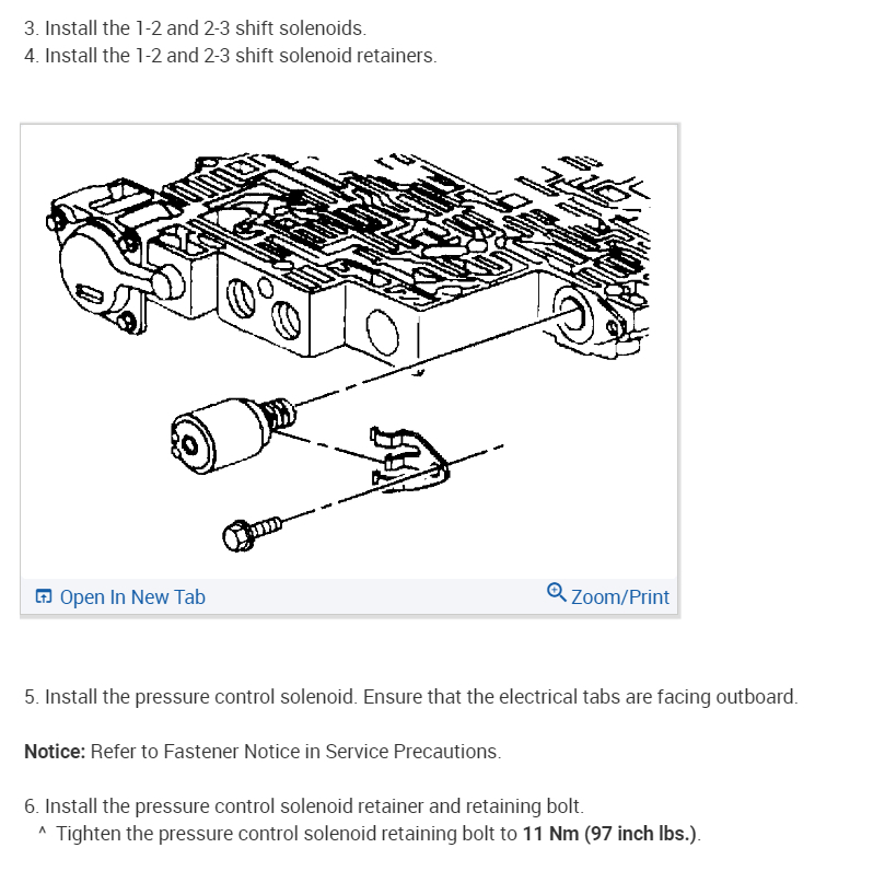

It sounds like the first gear control solenoid has gone out. Here is the location in case a code comes up for it.
