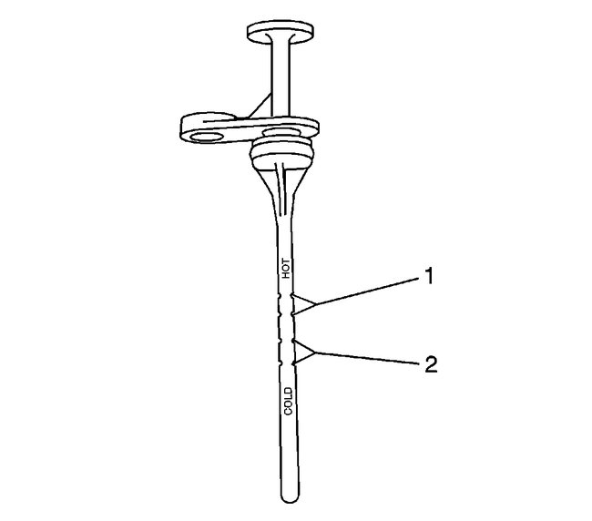

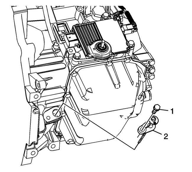

Why does my transmission seem like it goes into neutral a few seconds after going? I can turn key off and start right back and same thing.

That could be due to a few things. The first thing I recommend is checking the transmission fluid level and condition. Here are directions specific to your vehicle for checking. The attached pics below correlate with the directions.

3. With the engine at idle, manual shift through all transaxle ranges and return to the PARK position. Leave the engine idling.
4. Clean any dirt or debris away from the area of the transaxle fluid level indicator.
5. Remove the transaxle fluid level indicator bolt (1) from the transaxle.
6. Remove the transaxle fluid level indicator (2).
7. Wipe away any transaxle fluid from the indicator.
8. Insert the indicator into the transaxle until fully seated.
pic 2
Important: Inspecting transaxle fluid level when not at normal temperature can give an incorrect measurement. The transaxle fluid expands when warm.
9. Remove the indicator and inspect the level and the condition of the oil on the indicator:
* Transmission fluid level at normal operating temperature (1)
* Transmission fluid level if cold (2)
