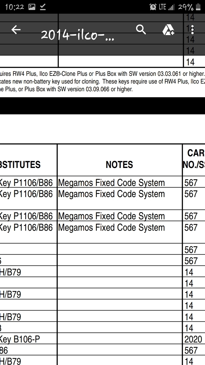

It is a Transporter key.
B99-PT5
USA
Sep 2, 2019 at 8:27 AM

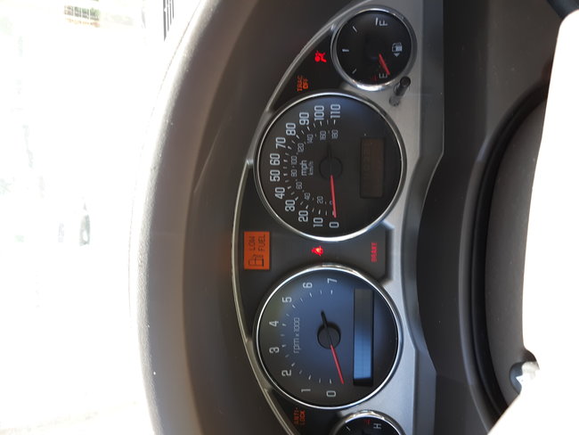

I have 4c pictures total to show what my dash is showing after 10 second's.

The security light never came on, only the battery and low fuel light was flashing and the lights never stopped.

So last night I tried the key/ignition idea from you and this morning my son came to tow my car to O'Reilly's to be code scanned and the only on the dash is "low fuel". So my son said no use if not showing a "service engine " light.
So I just went back out to start it and low fuel still stays on but I could smell an odor kinda like exhaust but not a converter smell. So I do not know.
Sep 7, 2019 at 6:24 PM

The (CEL) check engine light does not need to be lit. It is only lit when an active failure is happening. Its semi complicated but basically the CEL is only lit when the computer sees an active failure. So if conditions change and say a certain sensor is not used under those conditions the computer turns the light off and stores the code in memory. Just because the light is not on does not mean you don't have codes stored. I have even seen a computer just store a code and never turn the light on.
I would also suggest you take it to a shop and not a parts store. I don't know of any stores that use advanced scanners. They all use basic ones. Basic scanners will show engine codes only but there are 4 other systems that will throw codes. So I would find a shop that gives free estimates and have them throw an advanced scanner on it to retrieve all codes. Make sure you ask them if they use advanced scanners to see all systems.
As for the smell, this is probably normal. The converter does not function until it reaches operating temp so you will smell un-burnt fuel until it does.
The fuel light being on is normal if there is under a 1/4 tank of gas in it.
