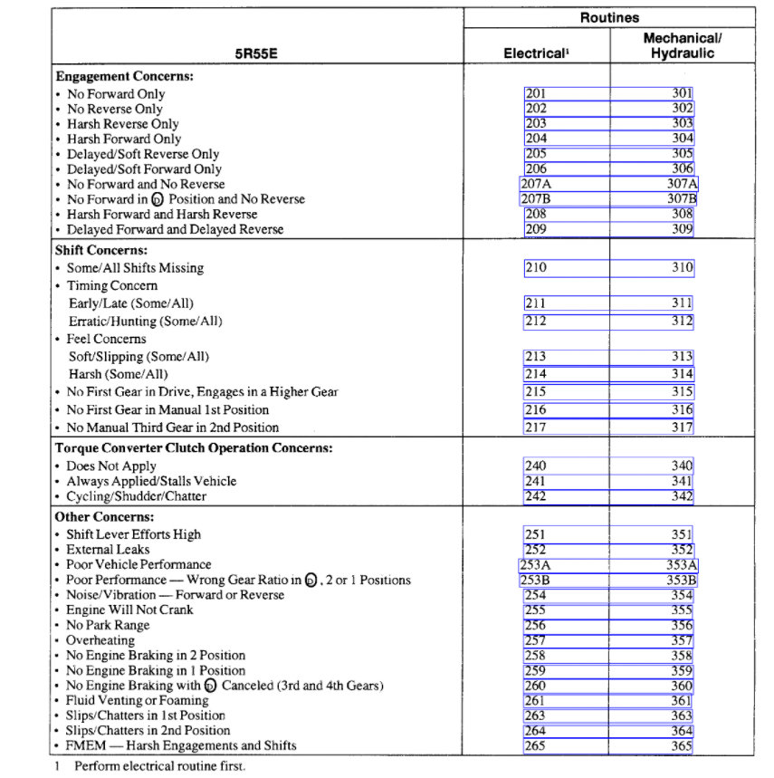

Truck runs but will not move, transmission issue
210,000 MILES • 4.0L • V6 • 2WD
MCETEXAS
The info I've gathered points to overdrive sprag. In replacing this part, do I need to purchase the planetary? Thanks
Dec 15, 2021 at 2:05 PM
Good morning,

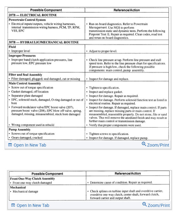

I would do some diagnostics first before assuming anything.
I would check and see if you have any mainline pressure. Without pressure, nothing will work. You could have a front pump failure or torque converter failure and must be ruled out before pulling the unit and inspecting.
I attached a flow chart for you to follow for the failure.
Let me know if you have any other questions.
