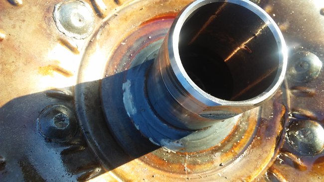

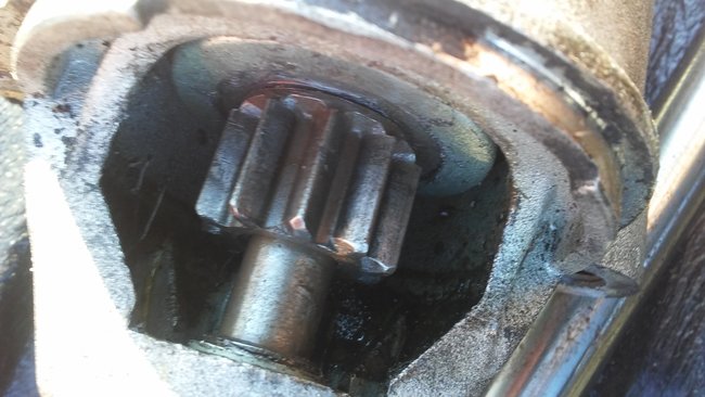

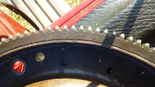

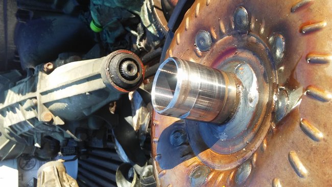

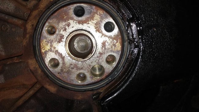

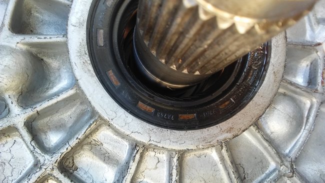

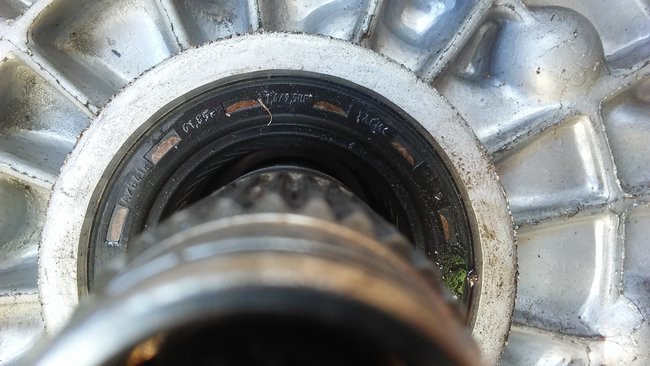

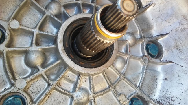

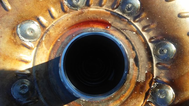

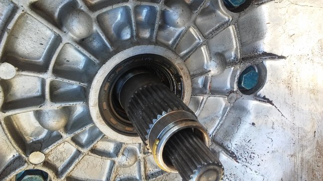

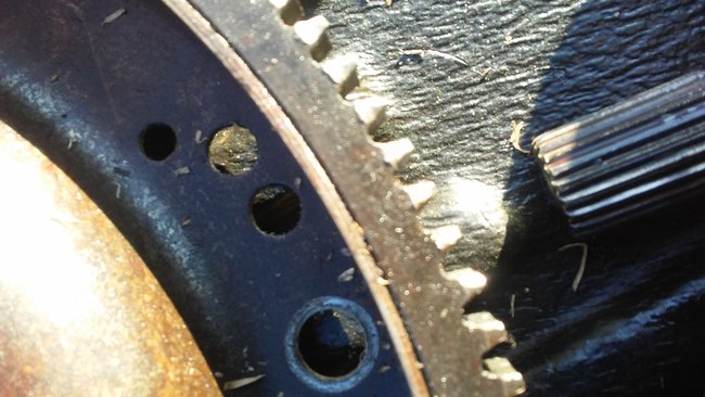

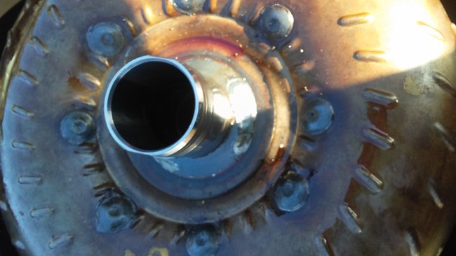

Ok I took the transmission back out took the starter and flywheel off too because I couldn't see any signs of anything with the torque converter or the transmission. I found some scarring on the teeth of the flywheel and the starter. Please help me figure out what is going on. Not sure if it will be helpful but the reason I changed the transmission is when you put the original one in drive it took a little bit to actually grab and start driving like 30 seconds or more maybe a minute waiting for it to engage. Then when driving if you didn't take off very slow it would jerk and sound like gears were grinding. Then when it went from first to second it did the same thing.
I took some pictures to hopefully help you help me. And just as soon as I'm done spending money to fix this truck I will be donating to this page because you have surely been very patient and helpful.
Mar 16, 2017 at 8:56 AM
JAQUICK
  • 10 POSTS
Would the pilot bearing be inside the hole behind the flywheel or in the flywheel itself? I have not seen it and based on the first picture it doesn't look like there is one in the hole behind where the flywheel was. And if somehow the pilot bearing is not there could this be the cause of what is going on? Again thanks so much for your help.
Mar 16, 2017 at 2:33 PM
  • 55,433 POSTS
Can I see i picture of the front of the converter to see if it fits into the end of the crankshaft?
Mar 22, 2017 at 7:30 AM
JAQUICK
  • 10 POSTS
I didn't think to take a picture of the front it has been put back into the truck now. I changed the pump and seated the torque converter properly. It hesitates to engage when put in drive or reverse. But shifts great after if engages. It was late and I didn't let the motor warm up before driving it. Is it possible this could be a result of the fluid not having gotten warm and moved throughout the entire transmission? I pray!!
