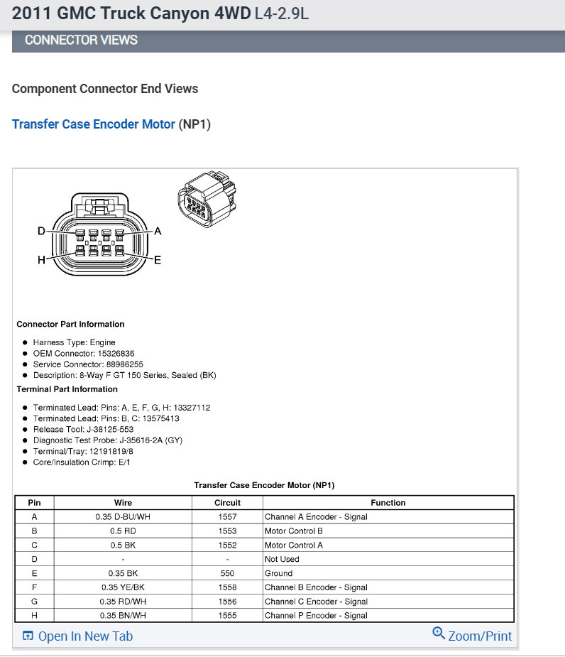

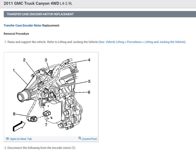

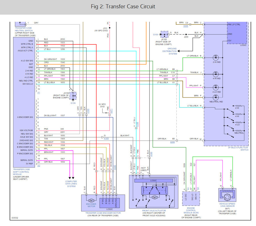

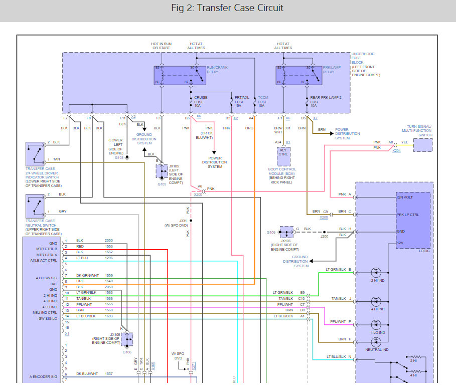

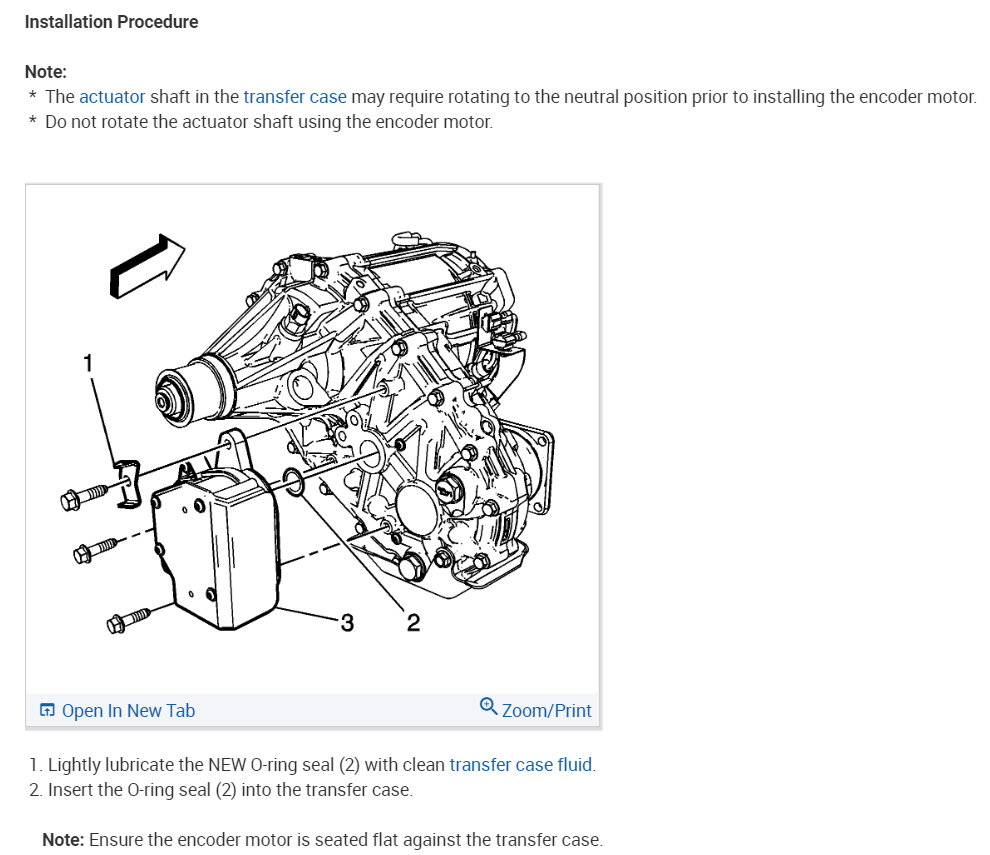

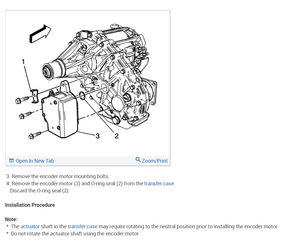

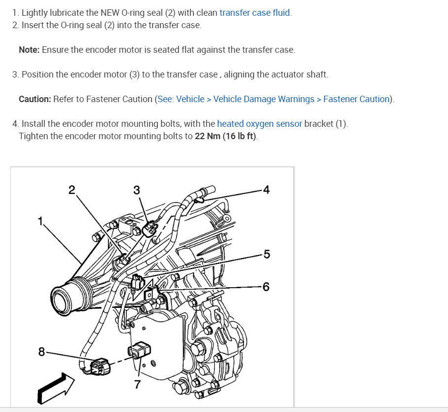

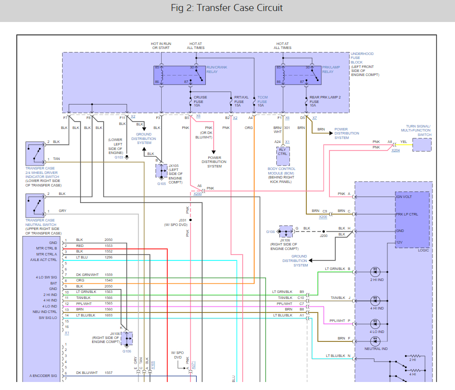

i have taken the motor apart and I need picture and specs to put back together. And how to test. Also, I need to know what feeds the red wire to motor no 4x4 4 high flashing than back to 2 high any information is help full.
Sep 30, 2022 at 3:50 PM
  • 55,711 POSTS

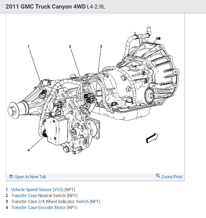

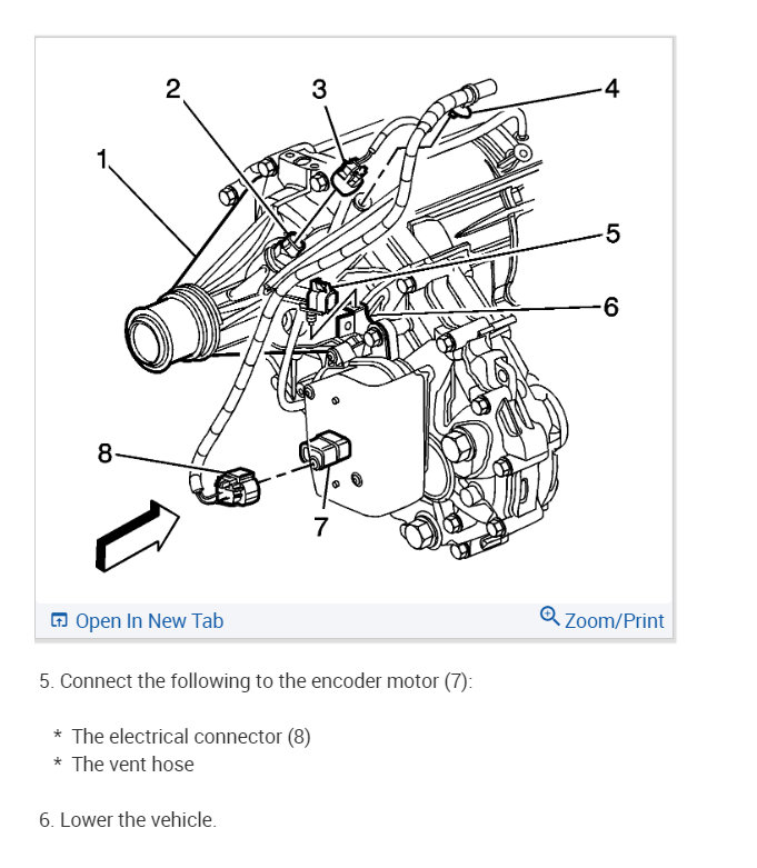

They really don't show us how the motor goes back together; most people just get a new transfer case actuator motor. here is how to replace it and the wiring diagrams that control the actuator motor. I may be able to help if you load a short video or images of what you are trying to do. Check out the images (below). Let us know what happens and please upload pictures or videos of the problem.
