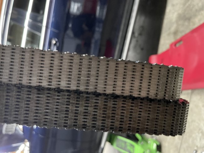

This car is always AWD. There was no noise at all except for when you downshift hard say to pass someone you will hear a chain skip, similar to one on a bicycle. Does it for couple of seconds and goes away. No lights on the dash. No, the fluid drained quickly not thick.
Friday, December 24th, 2021 AT 2:47 PM
Okay. That helps. Then yes it looks like that chain is slapping the case. It is unlikely to be slipping because those think chains will damage the teeth of the gears and you would see that.
Take a look at the case and surrounding parts and see if there are any witness marks that would be the chain slapping.
If you see nothing, then I suspect the transfer case if just worn out.
That is very common with AWD vehicles and there is no info on rebuilding them.
I am sure you can, but you would have to find parts and then work through it. MB says to replace them.
One thing you need to do before you do anything more than replace the fluid is make sure all four tires are the same size. I don't mean the same size that is stamped on the side. I mean they actually measure the same.
Use a string and wrap it around each tire and make sure they are within a quarter inch of each other circumference wise.
If they are not, they damage the transfer case and the only way to fix that is to replace it.
As for the fluid, if it came out fast then that is ATF. No question.
Friday, December 24th, 2021 AT 6:48 PM

In just checked the teeth on both gears and they are in excellent shape. Rotated the shafts on the transfer case and they are smooth, no signs of a bad bearing. If this was internal and major there would have been a continuous noise if I am not mistaken, but the fact that it only does it once there is a hard slam suggests it's a skip, similar to a bicycle. Once I get the chain I will send you a picture, am almost sure it is stretched.
Friday, December 24th, 2021 AT 7:01 PM
Yep. So that was the next step. If there are no signs of slapping and the teeth are okay the chain is stretched.
However, that is rare so if you have a chain coming, just lay them on a table to compare them. They should obviously be the same length.
Let us know because that would be interesting to see if this is the issue. Thanks
Saturday, December 25th, 2021 AT 3:49 PM

As I suspected it is stretched and now it has minimal play. Putting fluid tomorrow.
Tuesday, December 28th, 2021 AT 4:00 PM
DIVIDES
  • 898 POSTS
Just filled it out and driven it all good, no noise.
Tuesday, December 28th, 2021 AT 5:01 PM
That is great news. Something drastic had to have happened to that because I had only seen a handful of chains stretched and none of them were that thick.
Great find. Clearly you have good instincts. I will remember that for next time.
Thanks again for the updates and the picture.
