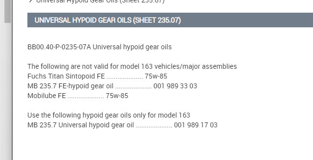

I am changing the chain in the transfer case as it has a slack and causes a noise when accelerated hard, common. what type of fluid is used in it?
Dec 18, 2021 at 7:34 AM

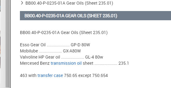

Looks like this vehicle takes gear oil in the transfer case so I attached the info below on this from the manual.
However, I am not sure if this vehicle has a drain plug or not as I am not finding a process from the manual on how to change the fluid.
This is typical for Mercedes because they don't put a lot of stuff out on this type of stuff.
Let us know what other info you need on this. Thanks

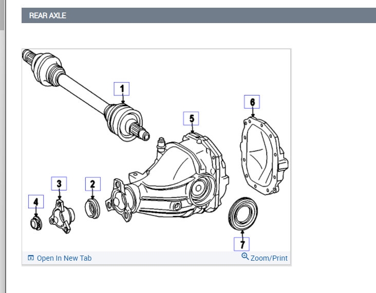

I am a bit confused on what this means in the picture. But I found someone in the forum mentioning this...there are 2 differentials? one rear and one in front? plus the transfer case? I thought the transfer case behind the transmission is the same as the front differential...
This is what they said:
(I did it on my X164 and plan on doing the same on 2015 GL 550 as well.
Transfer case uses the same Trans fluid.
Front\Rear Diff uses 75W90 Oil. )
Isn't the part that has the chain the transfer case?
Dec 19, 2021 at 8:11 AM

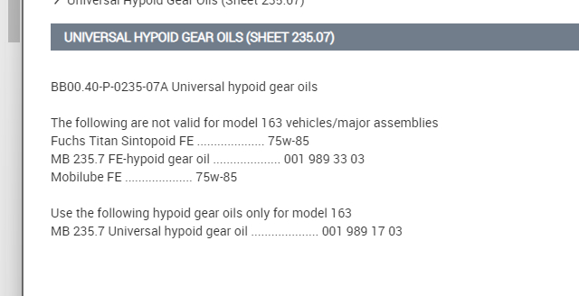

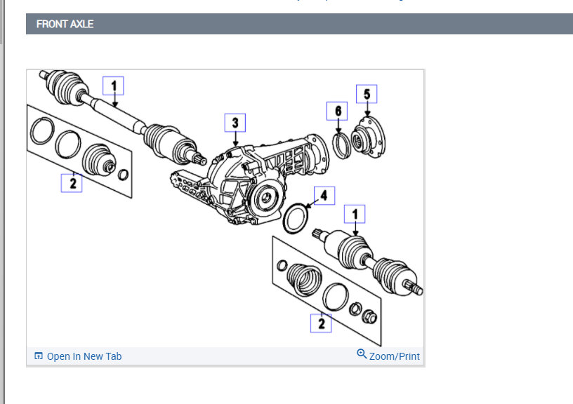

The only transfer case that takes ATF is BB00.40-P-0236-12A.
So if you have this transfer case then that is correct. However, I am attaching pictures of the front and rear axle plus the part number of the transfer case that the manual has for this vehicle.
It says the front and rear axles take 75w-85 and the transfer case takes what I attached before with the exception of that unit number above in this post which takes ATF.

Okay. That appears to be the 750.65 transfer case which would be ATF.
Hopefully you find some stampings that will support either of these numbers.

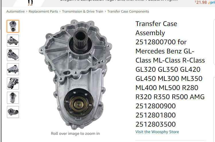

I go down to see the transfer case but there are no numbers anywhere on it. But i see the drain and fill round plugs.

And to be clear I am talking about the one that is right behind the transmission which has the driveshafts attached, not the front case which has the axles attached.
Dec 22, 2021 at 12:08 AM
Perfect. That is the transfer case and those are the drain and fill plugs. Based on that, I suspect you are correct that this is the unit that takes ATF.

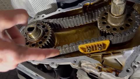

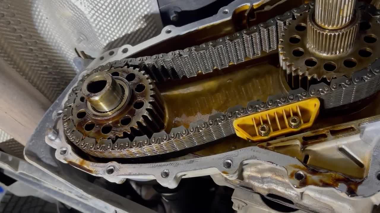

Drained fluid, and it's pretty much dark black. Dropped driveshaft center bearing bolts so i can have room to pull transfer case cover. Wow this chain is loose. They only have one guide, but how can they become so loose? Just from stretching. This is insane.

This car is always AWD. There was no noise at all except for when you downshift hard say to pass someone you will hear a chain skip, similar to one on a bicycle. Does it for couple of seconds and goes away. No lights on the dash. No, the fluid drained quickly not thick.
Dec 24, 2021 at 6:47 AM
Okay. That helps. Then yes it looks like that chain is slapping the case. It is unlikely to be slipping because those think chains will damage the teeth of the gears and you would see that.
Take a look at the case and surrounding parts and see if there are any witness marks that would be the chain slapping.
If you see nothing, then I suspect the transfer case if just worn out.

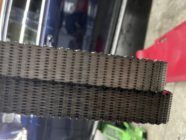

In just checked the teeth on both gears and they are in excellent shape. Rotated the shafts on the transfer case and they are smooth, no signs of a bad bearing. If this was internal and major there would have been a continuous noise if I am not mistaken, but the fact that it only does it once there is a hard slam suggests it's a skip, similar to a bicycle. Once i get the chain I will send you a picture, am almost sure it is stretched.
Dec 24, 2021 at 11:01 AM
Yep. So that was the next step. If there are no signs of slapping and the teeth are okay the chain is stretched.
However, that is rare so if you have a chain coming, just lay them on a table to compare them. They should obviously be the same length.
Let us know because that would be interesting to see if this is the issue. Thanks

As i suspected it is stretched and now it has minimal play. Putting fluid tomorrow.

Just filled it out and driven it all good, no noise.
Dec 28, 2021 at 9:01 AM
That is great news. Something drastic had to have happened to that because I had only seen a handful of chains stretched and none of them were that thick.
Great find. Clearly you have good instincts. I will remember that for next time.
Thanks again for the updates and the picture.
