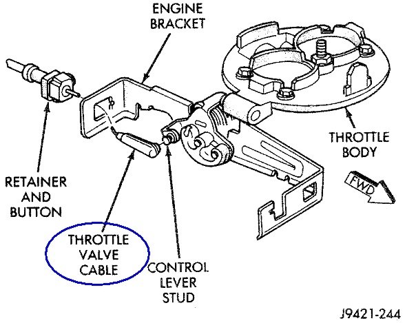

Cooler line developed a leak and truck was driven approx 45 miles until vehicle had no forward or reverse gears. Truck sat for 8 months at which time filled trans back up and surprisingly had all forward and reverse gears but only if manually shifted. Overdrive seemed to be not working as 80 mph would be about 3,000 rpm's. After about 3 months the transmission began shifting normally but only for about a month at which time it stuck in first with no up-shift. Replaced governor solenoid and sensor but this did not help. Occasionally it will shift to second but mostly stuck in first. When had the pan off adjusted the band. It had almost 1" of play and adjusted it to approximately 1/8" of free play. Possibly bad parts that I put back in? At a total loss on what to do.

The best clue is it was sitting for quite a while. Check for free movement of the throttle cable. When they stick, it is in the open-throttle position. That tells the transmission you're under hard acceleration and it will delay the shift points to much higher engine speeds.

That's the common symptom. Is that cable free?
The first time this happened at the dealership, the transmission specialist wasn't expecting to find a problem with that cable, so he overlooked it and wasted half a day trying to figure out why it was staying in first gear. After that we saw this quite often, but most of the time the cables were merely sluggish, not stuck tight. It's when they sit for weeks with no movement in that cable that they become tight.
When you watch down by the left side of the transmission, you should see that cable sliding freely when a helper works the accelerator pedal. If you aren't sure, remove the cable from the lever on the transmission, then drive the truck to see if it up-shifts. It will shift too soon and line pressure will be low, so don't get on it as it will cause the clutch plates to slip and overheat.

I did what you recommended and checked the cable. It is moving freely. I also rechecked the fluid level and it was correct. I appreciate your time on this matter. The conclusion I'm coming to is that the solenoid and/or sensor that I installed were/are faulty. They aren't name brand parts as I was trying to save a buck. It might be a case of getting what ya pay for. I will follow up on any future progress.
