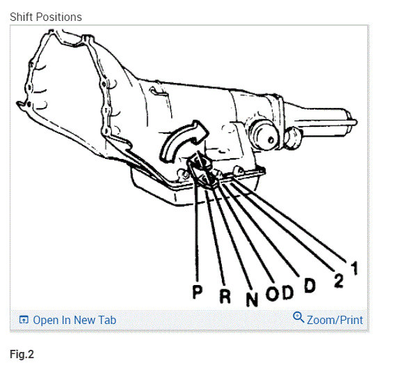

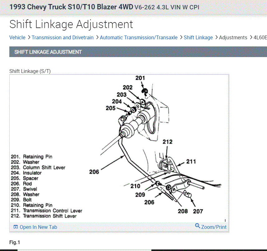

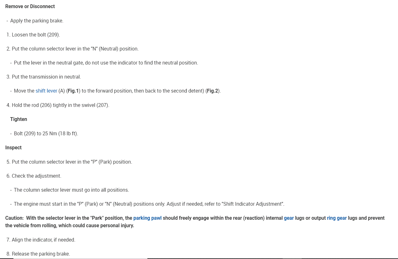

I'm starting to question the shift linkage. On 4-Speed automatics, it is possible to drive the vehicle in 3rd gear rather than "overdrive" and not perceive it. Typically, this condition occurs when the shift indicator or the shift linkage/detent is misadjusted. Misadjusted shift linkage can also result in improper signals to the ECM, which can result in less spark advance, and results in a drop in fuel economy.
I'm questioning this because what happened that seems to have led to the issue shouldn't have caused this to happen. Running for less than 5 seconds wouldn't have emptied the fluid.
Do me a favor. Let's see if the shift linkage is out of adjustment. When you were working on the vehicle, anything could have happened.
If you look at the pics below, they explain how to adjust the linkage on this vehicle. Take a look through them and let me know if you are comfortable performing them. Additionally, I am making the assumption that this is an S-10 Blazer and not a full size. If that is incorrect, please let me know.

The shift linkage/indicator has always been one off. Example or matter of fact. Park always above the park indicator, then down shifting reverse, neutral, drive.
Feb 26, 2022 at 5:24 PM
  • 110,244 POSTS
Try adjusting things. If that has been the case, there is a chance it is finally far enough off that it is causing the issue. Although you see it off in the vehicle, it could be off at the transmission and causing this.
