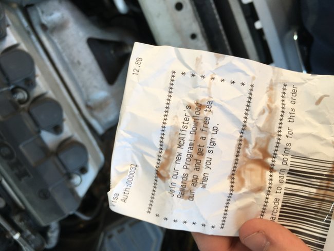

I’m young and just traded my Ford for this car thinking it’s a great trade but after checking the transmission fluid I’m not so sure. can I get away with a flush and not driving it or am I bumming? Can I still drive it here and there until I can get it flushed or don’t risk it?

The fluid looks kinda burnt. Does it smell like it's burnt? If it's burnt it will do more damage by changing it.Once the fluid gets that way the friction material from the clutches stays in the fluid.After changing to fresh fluid usually the transmission will start slipping.Here is a transmission service tutorial if you want to change the transmission fluid:

What does it look like on the dip stick? If it's foamy and light pink, the cooler built into the radiator might have corroded through. Antifreeze in the transmission fluid will melt the soft first layer of bushings, so the radiator must be replaced right away, then the transmission must be flushed to get the antifreeze out of it. Transmission fluid in the cooling system will rot the rubber radiator and heater hoses from the inside, but that will take some time.
If the fluid looks real dark and / or smells burned, the transmission was overheated at some point. If any damage done was minimal, you may get away with a simple fluid and filter replacement. That exchanges about half of the fluid. That is usually enough to replenish the additives. Overheated fluid can form varnish that can build up in the bores of the valve body, resulting in delayed shifts of even failure to shift.

I just smelt it and it smells kinda sweet but a little burnt. There is little black spots in it. Is that metal shavings?
Mar 27, 2020 at 10:17 AM
KEVIN LAY
  • 7 POSTS
I do not know if you can tell.

Hello again, I did a fluid change today and it was unremarkably black. I don’t think it’s been changed since the car was made and it’s 170,000. I put max life in it and drove it for awhile, seems to shift fine. Soon realizing I should’ve just left the black fluid in there at this point. How long would it take to notice if the new fluid is gonna ruin my transmission completely?
It is a Honda, should I do another fluid change if it doesn’t show any symptoms to get all of it out or don’t push my luck.

Yes, I would wait like a month before changing again. Just drive around for that length of time to see if any symptoms like slipping start to happen.Black is bad so I'll keep my fingers crossed for you.Hope this helps and thanks again for using 2CarPros.
