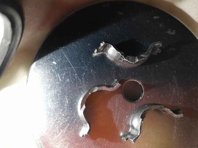

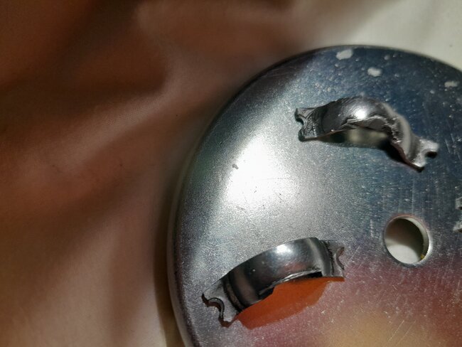

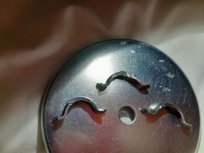

Well, I have a wonderful truck and upon doing a gear oil fill i notice metal shaving in the magnet plug and then a couple of metal pieces about the size of a dime. It looked like it was circular at one time but was in 3 pieces. I'm really scared at this point, I don't have the money for another transmission, is there a reason for alarm? Is there something I can do or am I just out of luck plain and simple?

Thanks so much for the how-to instructions, but wanted to mention that on the pieces I noticed what looked to be something that was up against this piece and was apparently applying friction too.

To this piece because I noticed where it was being grinded down by possibly, I'm thinking the gears or something of this nature. the piece as I said was circular but the griding against it had broken the piece. so, I examined it and noticed where this friction was the cause what this piece is where it's could be located as well as what parts would do this, i'm hesitant of my next move at this point would hate to be hasty maybe you could direct me as to trouble shooting like process of elimination before having to rebuild or by a used one which I'm told is very expensive as I'm on a fixed income your advice is my only hope at this time. if you don't mind, I would be so appreciative I've been offered so much money for this truck for some reason, but I love it, it's a good truck.

I'm sorry but to answer 1 of your questions, I failed to mention the reason I even assumed it need some gear oil was it started from time to time being somewhat difficult for me to shift into 3rd gear not all the time just time to time also when I would shift it had start feeling like to me that it needed lubrication because even though the majority of the time I had no problem shifting but at the same time shifting wasn't smooth like it usually is not it felt crunchy like it had no lube to make this a smooth switch from 1 gear to the next so that red flag I couldn't ignore maybe this is helpful to you to know.

Can you please upload a picture of the piece you found?

Hi, pics here are the pics.
Sorry about the other 2 pic other 2 pics they d
on't belong hopefully you can.
Enlarge these pics to see better detail.

Thanks for the images, so these came out of the oil drain hole for the transmission. They look like part of the shift shaft brackets or they could be part of a bearing retainer. I think you will need to have the transmission built.
