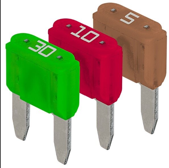

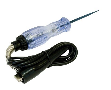

Definitely the fuses are the best place to start. Pulling fuses and looking at them sometime won't show it being blown. The best way to check is with a test light with them in place.
Here is an article of what I mean and will help conduct the testing:
Always check your test light on the battery terminals first to make sure it illuminates and is working correctly.
