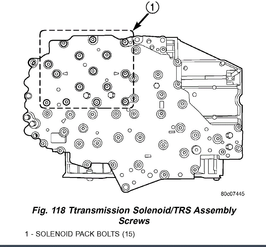

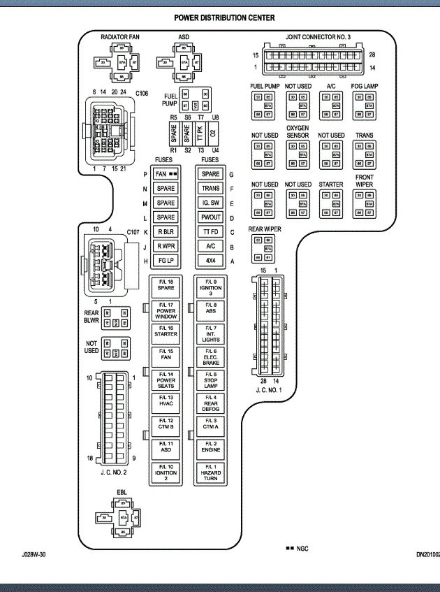

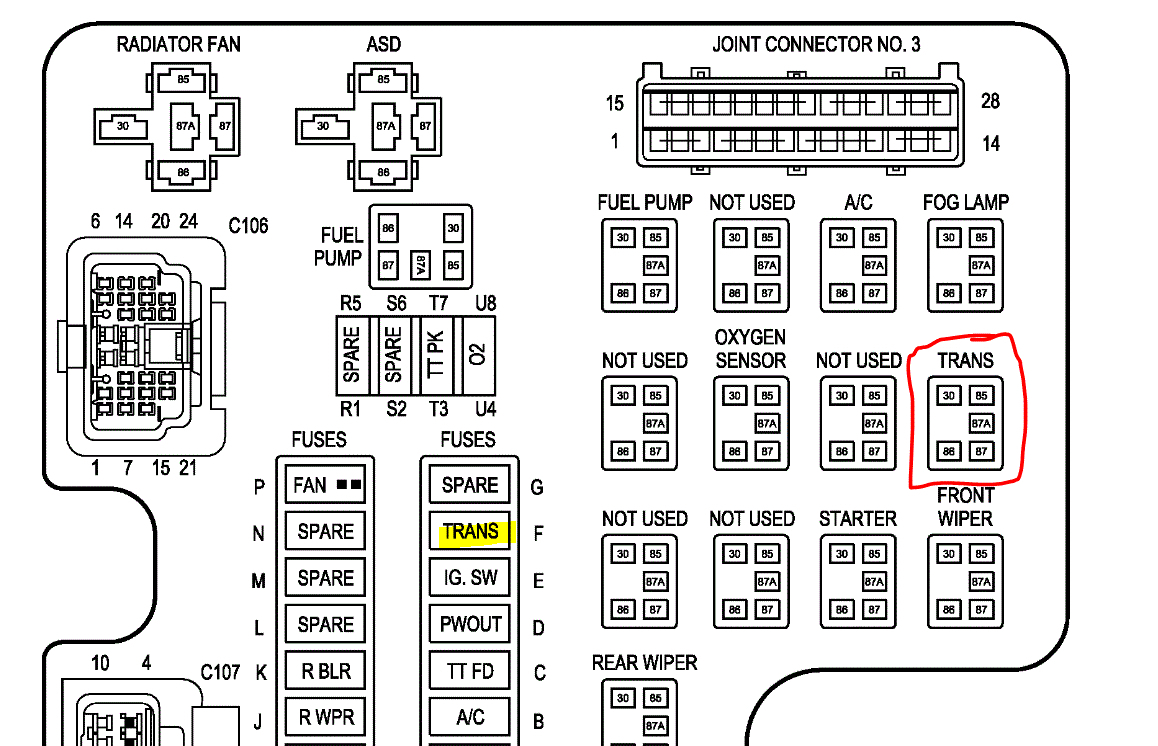

Yes, those codes are helpful. It seems there is a problem with voltage. Check and confirm all grounds are clean, the battery is fully charged, and there is no corrosion at points of contact.
Next, the codes related to the transmission are specific to a voltage issue. Check the transmission fuse and relay located in the power distribution box under the hood. See pics 1 and 2. I can't be sure, but I suspect the issue is the relay.
Here is a link that explains how to test a relay:
If you find all connections are good, then we need to check if power is getting to the transmission solenoid assembly. If there isn't, trace power to find loss. If there is power, replace the assembly. The solenoid assembly is located on the back side of the valve body. See pic 3
Let me know what you find.
