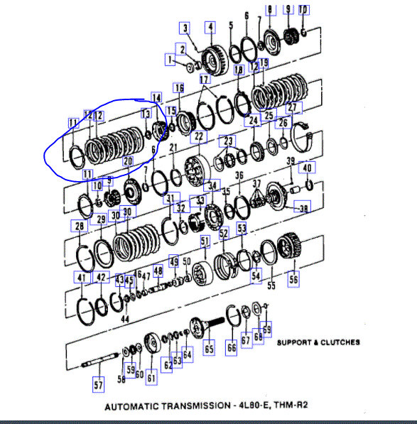

Went to top off the fluids. Added 1/2 quart transmission fluid and went to drive but wouldn't go forward. only reverse.

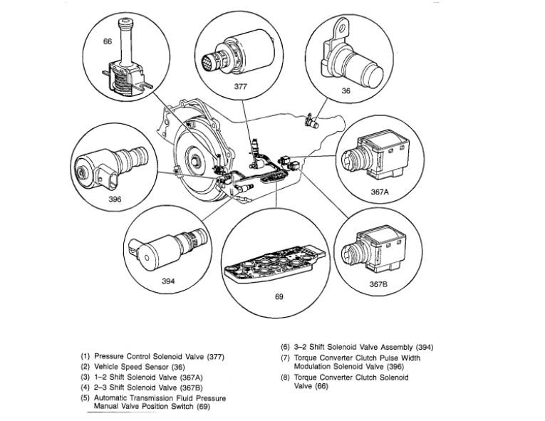

Lets start by checking for codes this guide will help us. You could have a shift solenoid not working.
This guide can help as well:

Good morning,
The fact it goes into reverse tells me the fluid level is correct.
If it does not go into drive or forward gears, there is most likely a failure of the forward clutch pack inside the transmission which controls forward movement.
This will require removal and dis assembly of the transmission to determine the failure. It would be a better choice to consider a used transmission to keep the cost down or replace it with a rebuilt unit.

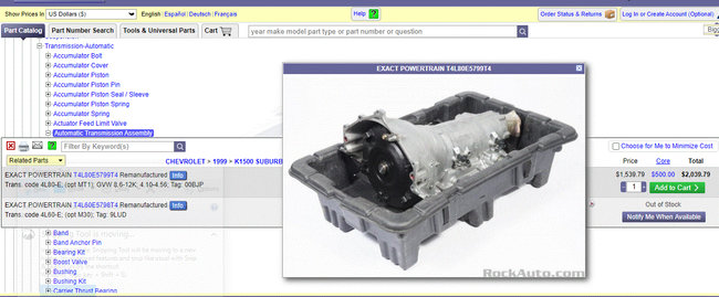

A rebuilt unit would be around $3,000.00 while a used one would be around $1,500.00. I found a rebuilt for $1,500.00 at rock auto. I attached it for you to view.

Did you verify voltage to all the solenoids?
Are there any codes set?
Sep 15, 2020 at 3:23 AM (Merged)
You will need to check for powers to all the solenoids listed and make sure the return wires back to the pcm are good as well.
Make sure the TPS sensor on the throttle body is good as well. do a sweep test from 0 to 5 volts with no glitches as it controls transmission shift points.
