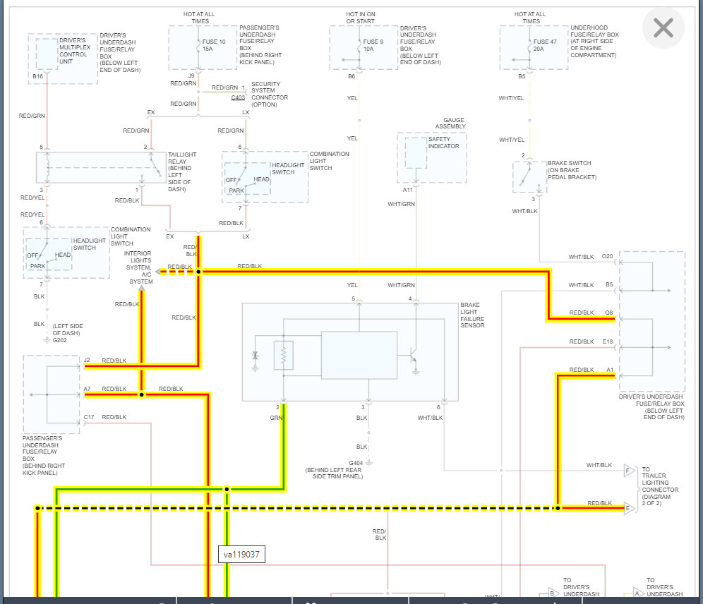

Taillights burnt out
2001 HONDA ODYSSEY
247,000 MILES • 3.5L • V6 • AUTOMATIC
CGONZ1065
Well, as you can see my van listed above, both lights only on the outside of the van in back are burnt out. I changed them but they won't turn on. My blinkers and the center lights that are on the back door come except those to outside corners. I checked the fuses and even the relay that says it's for the taillights. Is there another place I can check?
Apr 23, 2022 at 12:29 AM
There is a relay depending on what model you have. Is this an EX or LX?

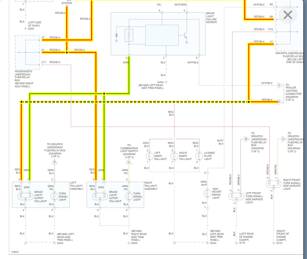

Basically, I am attaching the wiring diagram as we are going to have trace power through the circuit to find where the issue is.
Here is a guide that will help with this:
Please see the wiring diagram below and let me know what module you have, and we can figure out the next steps.
Thanks
