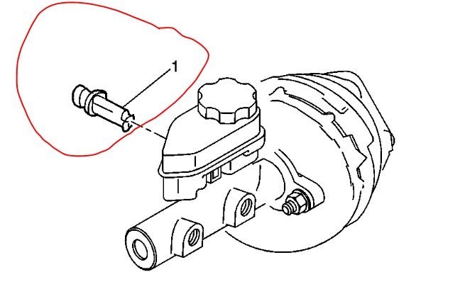

There is a brake fluid level sensor on the master cylinder. Double check that it is fully connected. If the vehicle thinks it's low on brake fluid, these lights will come on. I attached a pic of the sensor I'm questioning. Make sure no wiring was damaged to it as well.
Nov 22, 2019 at 1:57 PM
PUCK4HIGGS
  • 8 POSTS
I did remove that connector because it was tight when I moved the cylinder up away. I will check it to make sure i didn't buggar it up. However, if that was the problem why wouldn't it show the light right when I fired up the car? And why does the light only come on when I move the car. Then when the car is shut off the light goes away. When you fire it up again it's gone, until you move. Also my wife took it down to AutoZone while I was at the fire station and they tried to read the codes and they said there weren't any because there isn't a check engine light. Could there be something related to me messing around with the master cylinder? Baffled here.
Nov 24, 2019 at 11:43 PM
PUCK4HIGGS
  • 8 POSTS
Okay, here is what I did: I checked the connector and wiring which I believe to good. I verified by shorting the connector with a paper clip and it immediately gave me a low brake fluid alarm. I am almost thinking the switch and connector in the master must be okay also because I'm not seeing a low fluid alarm when it is plugged in. Although that connector on the master cylinder sure seems cheesy. So IDK. Unless it's possible for the switch in the cylinder to be bad and not show a low fluid alarm. The other thing that struck me was with the low fluid alarm active the T/C light still did not come on until I moved the car. Something is happening to the system to shut off the Stability System when the car is moving. It hasn't done this before until I put that ISS in and I can't get a correlation between the two.

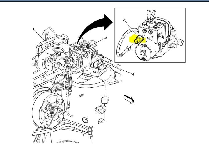

Anything is possible. On most GM vehicles, the ABS does a self check when the vehicle starts to move. That is most likely why you are getting the light after you start driving.
As far as there being no codes, it's most likely because their scanner can not read ABS codes. Something has caused the ABS to fail. As a result, the stability control is affected.
Because of where you were working, I need you to check both the connection and wiring to the EBCM (electronic brake control module). I attached a pic of it and feel you will recognize the part. It is under the hood near the master cylinder.
Nov 25, 2019 at 10:58 AM
PUCK4HIGGS
  • 8 POSTS
I checked that connection and it is solid. It is hard to even get to. The wiring and connector are in good shape.

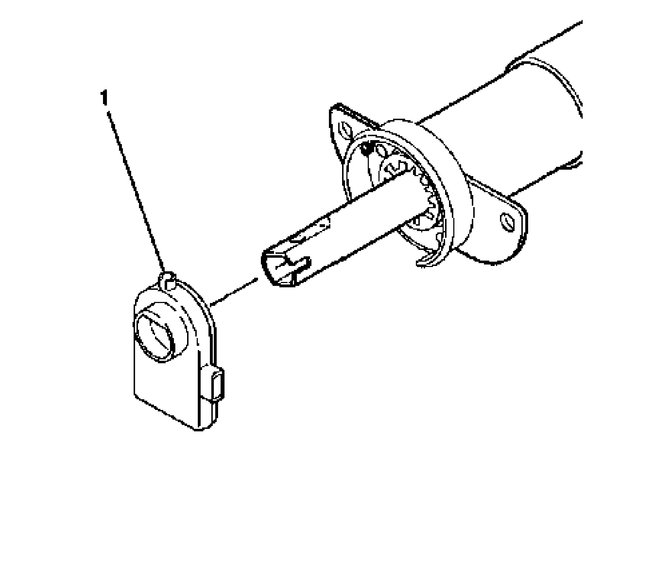

STEERING WHEEL POSITION SENSOR OR STEERING SHAFT LOWER BEARING REPLACEMENT
Steering Wheel Position Sensor or Steering Shaft Lower Bearing Replacement
Removal Procedure
pic 1
Caution: Refer to SIR Caution in Service Precautions.
1. Disable the SIR system.
2. Remove the steering column from the vehicle.
3. Remove the following from the steering shaft:
1. Steering shaft seal (1)
2. Sensor retainer (2)
3. Steering wheel position sensor (3).

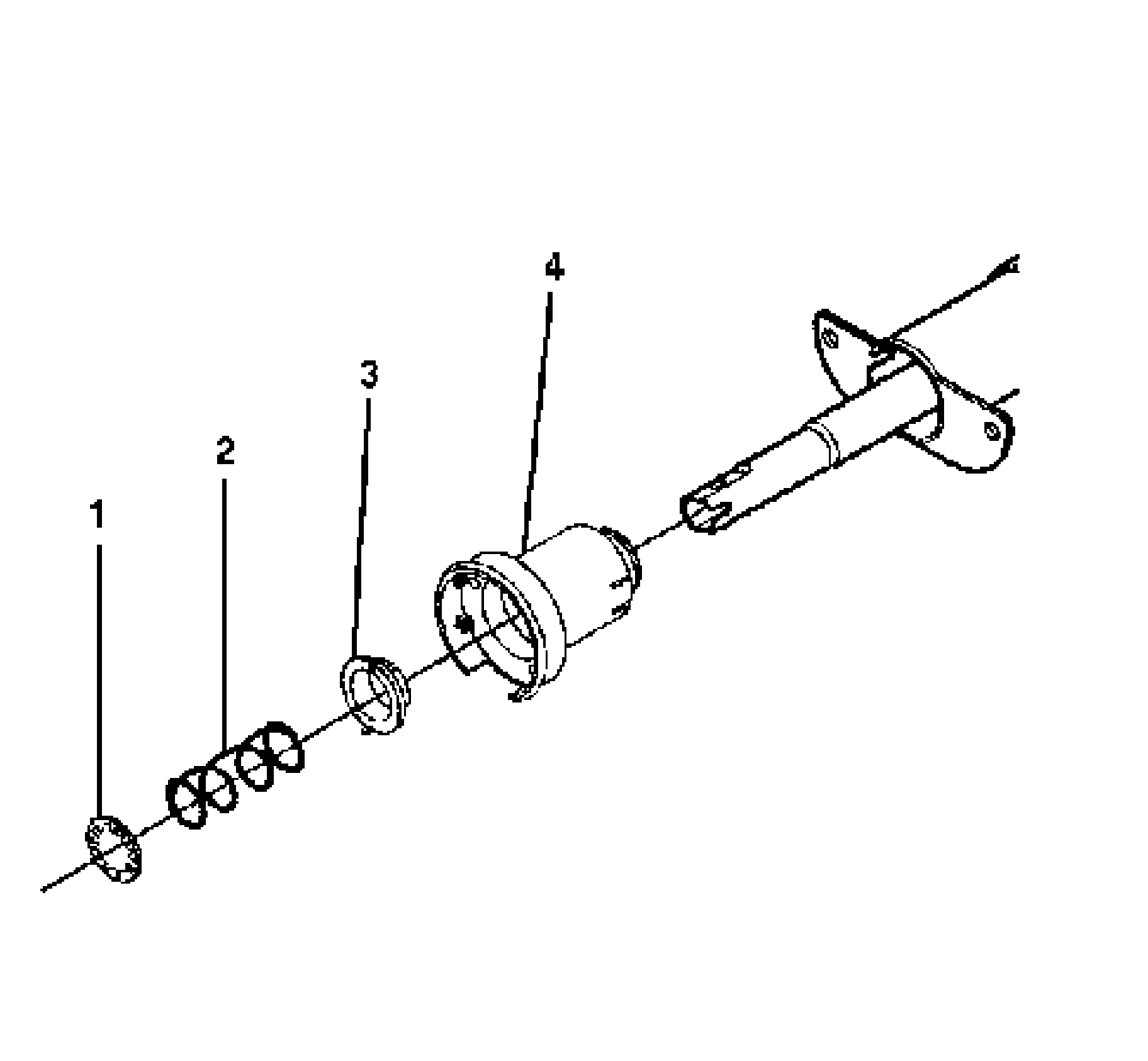

pic 2
4. Remove the following from the steering shaft:
1. Lower spring retainer (1)
2. Lower bearing spring (2)
3. Lower bearing seat (3)
4. Adapter and bearing assembly (4)

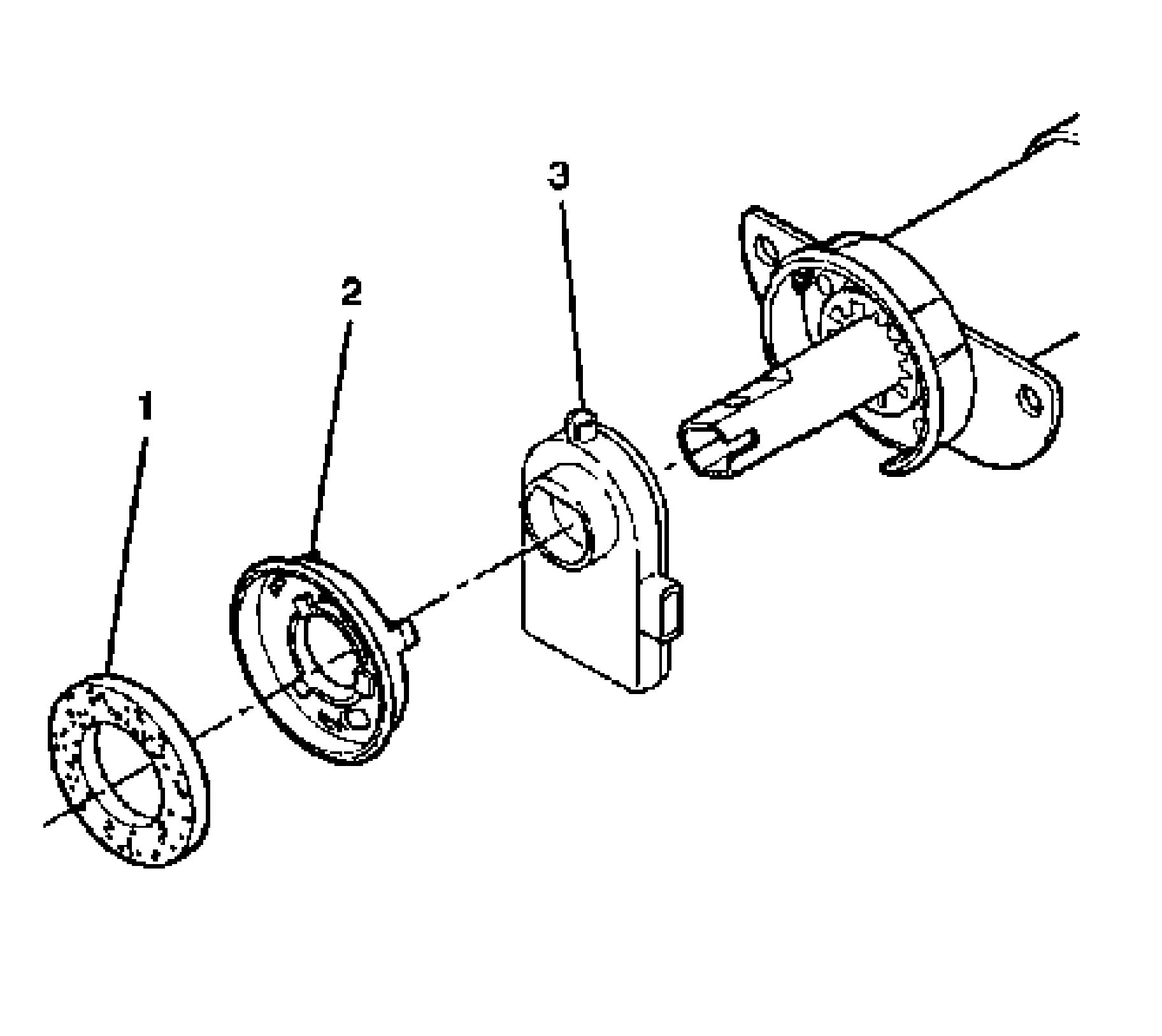

pic 3
1. Install the following onto the steering shaft:
Important: The lower bearing seat must be in contact with the adapter and bearing assembly.
2. Lower bearing seat (3)
pic 4
3. Install the steering wheel position sensor (1).
Important: Align the slots of the sensor retainer (1) to the ribs of the adapter and bearing assembly. Push the sensor retainer (1) until it contacts the steering wheel position sensor.

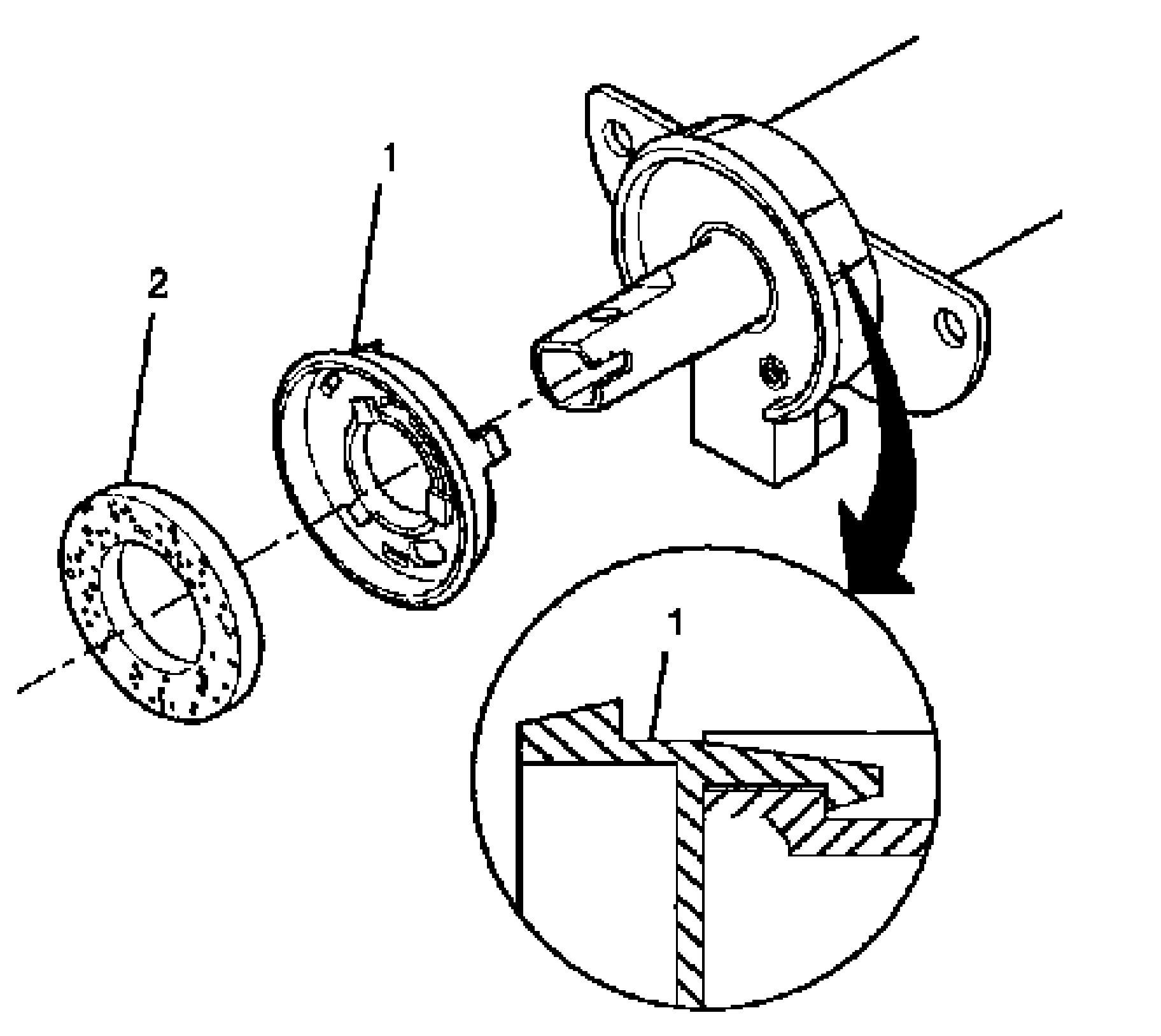

pic 5
4. Install the sensor retainer (1).
5. Install the steering shaft seal (2).
6. Install the steering column to the vehicle.
7. Enable the SIR system.
