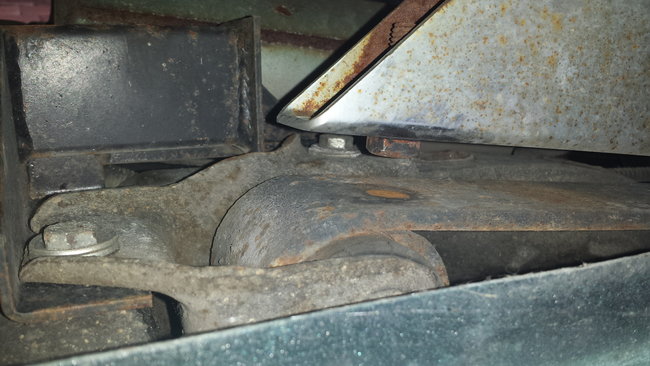

On the passenger side the snubber is missing causing the traction bar to hit the spring. It's actually metal against metal. On the driver's side there's a bit of a snubber left but it's deterioted.
My question is how do I replace the snunbers? I thought jacking it up would open up the traction bar from the spring but no such luck.

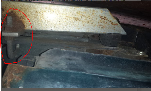

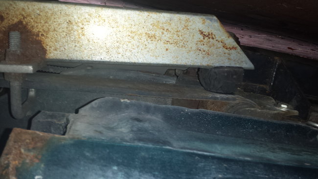

I attempted to upload 2 pictures the first time I asked the question I selected them but the upload didn't seem to do anything. I will try again. But the bottom line is this: The snubber on the passenger side is completely gone so the traction bar is tight against the lesf spring and I don't know how to separate the traction bar from the spring to install the new snubber which is like 1 3/4" high. On the drivers side there's a snubber there but it is smashed, again how do you separate the traction bar from the spring? People talk about adjusting them by cutting off a 1/4" like they are easily accessible.
The pictures uploaded upside down not sure why. The snubber on the driver's side is hard to see because it's dark. If you enlarge it or change the gamma you can see it better. 1st one is passenger's side.

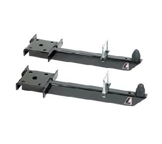

To remove the traction bar it's held to the rear differential with 2 u-bolts on the bottom of the spring as well as the catch you included in your picture. The most popular brand traction bars for a Camaro were called "Lakewood" I can think of 2 places you might be able to find the snubbers. See photos attached below. JEGS and Summit Racing and you can find both companies online.Hope this helps and thanks again for using 2CarPros.

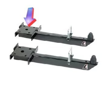

You can loosen the tracking bar from the differential and preposition the traction bars backward which will get you more clearance upfront. Or add a shim to the front of the mount to gain additional clearance.

The mounting 4 nuts/bolts that hold the traction bar into the differential.

The four bolts that hold it to the differential? Check out the picture below.

I think you mean the axle, not the differential. The problem seems to be that I have a slow leak in the air shocks and quite possibly a sprung mono-leaf spring(s). Not sure how one knows if the spring has sprung?
