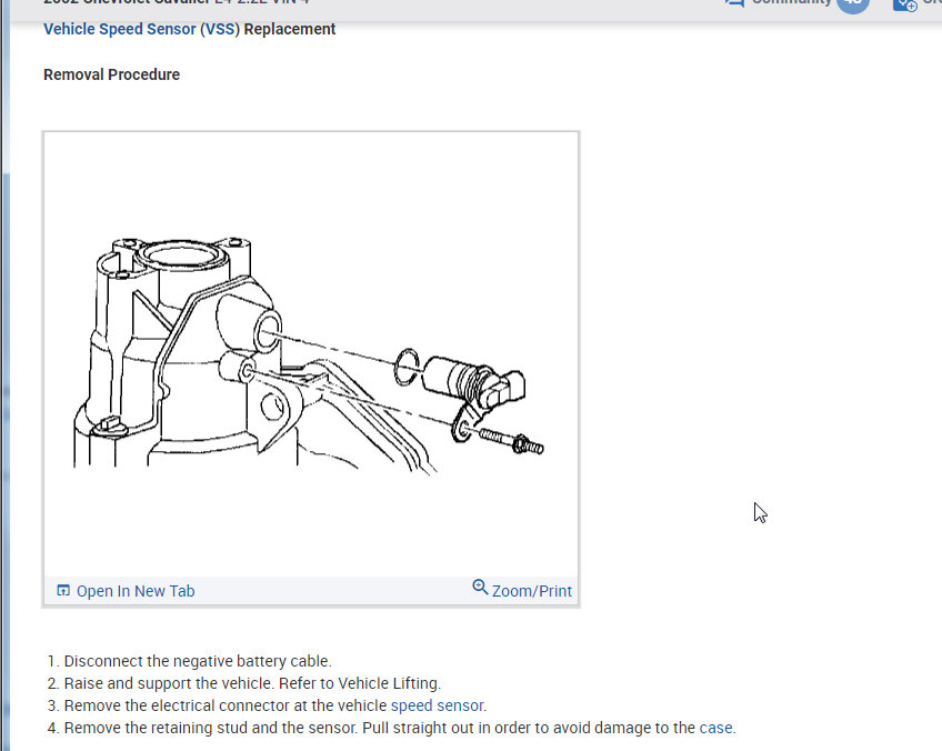

No there are zero lights on. no warning lights of any sort. but it is acting up it will drive in first gear and shift into second gear but it will not go any higher then second gear my RPM's go up and up, but it will not shift any higher then second gear. also when it does shift it's not shifting hard or anything. I did have a sensor changed. it was a sensor that was kind of on the bottom side of my transmission. I believe it was the speed sensor, but I could be getting it mixed up.

However, if you had the speed sensor changed, then that could be the issue. Can you look at the attached info and see if that is the sensor? If you are not sure do you have any paper work showing what was replaced? A part number would help.

I know the sensor looked just like that one and it was a friend of mine who switched it out for me. He said that yes it was the speed sensor. also the issues that I've been having started before I got the sensor changed. changing the sensor seemed to have zero effect on my car it didn't make it worse or better.

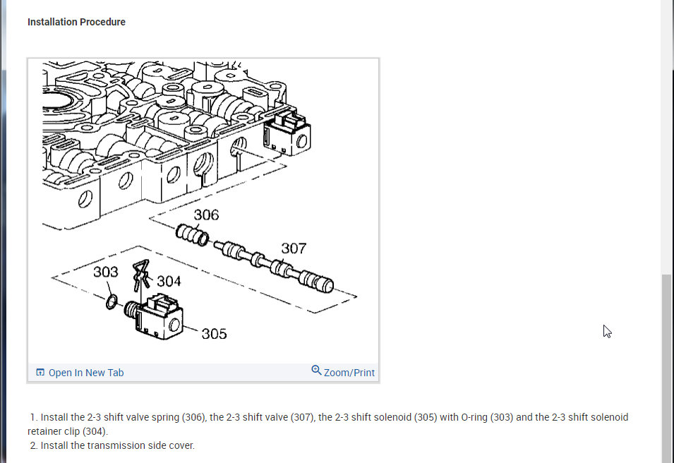

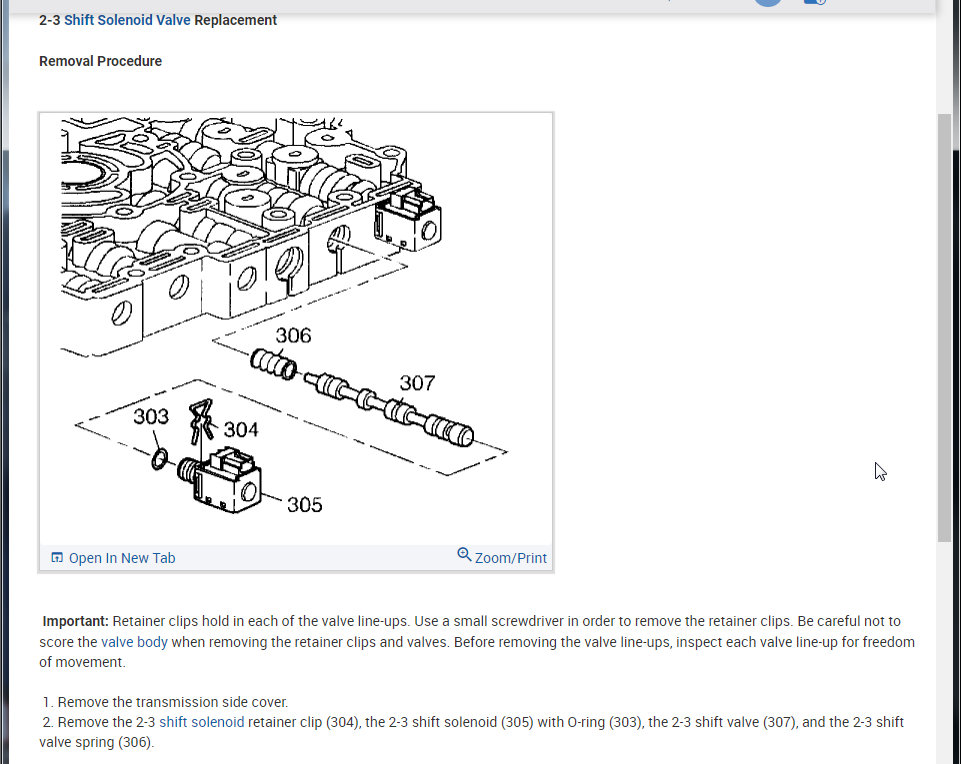

Okay. Can we step back and get the history on this? I think I am confused because you said the trac off light was on and it was not shifting past second but now that light is not on? Then you mentioned the speed sensor but said that this was happening prior to that and made no difference.
So the vehicle has been doing the same thing the entire time which is not shifting past second gear? Plus there are no codes?
If all this is about right the only thing I can think would cause this with no codes is a shift solenoid is stuck and not allowing the vehicle to shift. I attached the replacement process for this. We need to start with check the fluid and making sure it is clean and at the proper level. If it is, I would think we need to remove this and inspect it to make sure it is not stuck.

Basically you've got it the Trac off light was coming on at one point, but when it stopped allowing me to shift passed second gear was when I noticed I didn't have the light on any more. But anyways, I will definitely check into this. thank you for your patience and I appreciate your input. I will let you know what happens. thank you
Dec 12, 2020 at 9:13 AM
Okay. So that makes more sense. I don't think the trac light had anything to do with this. So if there are no codes and not shifting out of second, I have to think this is a mechanical issue which would be fluid or the valve.
Thanks for the update. Let us know what you find with the fluid and we can determine next steps. Thanks
