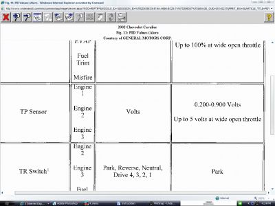

My car drives fine, than all of a sudden the Trac off light comes on and my car feels like I'm slamming into gear. This happens everytime I drive it. If I turn off the car and turn it back on, the trac off light goes away but my check engine light comes on. If I turn the car off and on again, the check engine light goes away and the car drives fine again.WTF? I get a Throttle Sensor malfunction- Sensor Low Voltage code. Could this sensor be the problem? I refuse to pay $90 just to know what the problem is. Can anyone help?
Jun 20, 2020 at 5:27 AM (Merged)
MERLIN2021
  • 17,250 POSTS
Grab your voltmeter and measure the values shown here.
https://images.2carpros.com/forum/automotive_pictures/62217_TP_1.jpg
