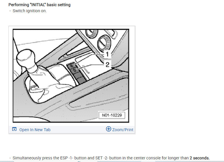

Had all 4 TPMS sensors replaced. We can get them to learn. Light goes out. After driving for a few miles up to a couple days the TPMS light flashes then goes solid again. I've relearned this 3 or 4 times. I have an Autophix scanner that I want to change from full load whatever the options are. Then switch it back. I've seen others say this fixes the issue. However, I need a 5-digit code to go into adaptation. Or could it be that the mechanic used different sensors other than ones from VW. I saw someone said that the valve stem caps need to be the original ones that came with the TPMS sensors because of a special coating. He threw those away. Please help.

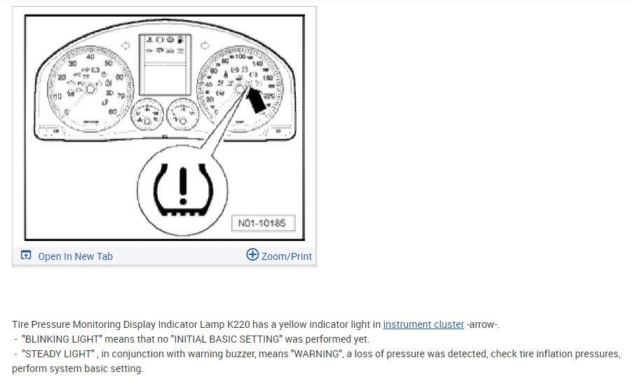

If the TPMS light flashes, that usually indicates an internal problem in the circuit and not a sensor. Have you tried scanning the can-bus to see if there are any codes related?

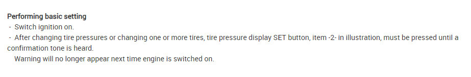

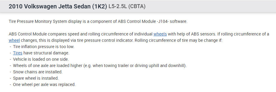

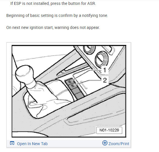

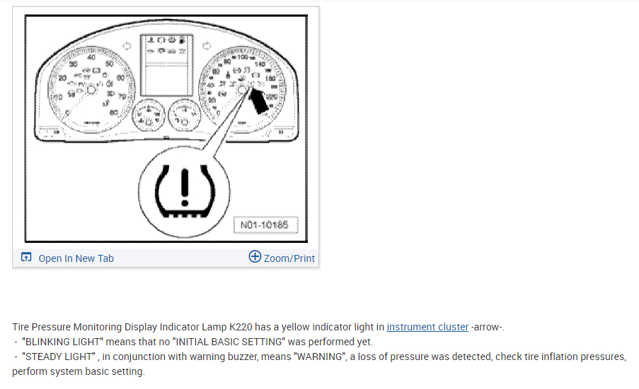

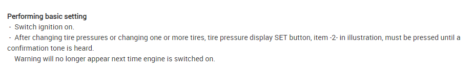

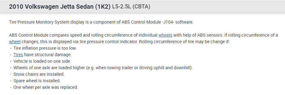

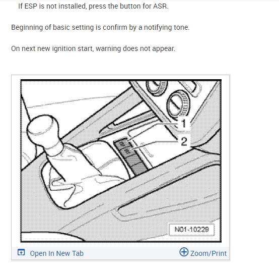

I attached the basic reset for the TPMS system. I suspect you have already tried this.
