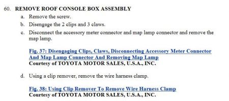

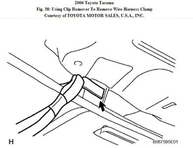

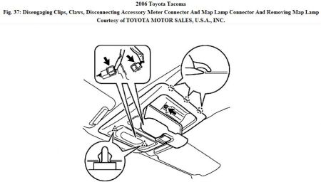

How do I get the console down that holds the dom light & compass/temp ? I know ther is a screw in the glasses compartment but it still wont come down, I got a new compass/wtemp.

Hi Dan, Hope the following is helpful.
https://images.2carpros.com/forum/automotive_pictures/192750_ConsoleRoof06Tacoma01_1.jpg
https://images.2carpros.com/forum/automotive_pictures/192750_ConsoleRoof06Tacoma_1.jpg
https://images.2carpros.com/forum/automotive_pictures/192750_ConsoleRoof06Tacoma01a_1.jpg
