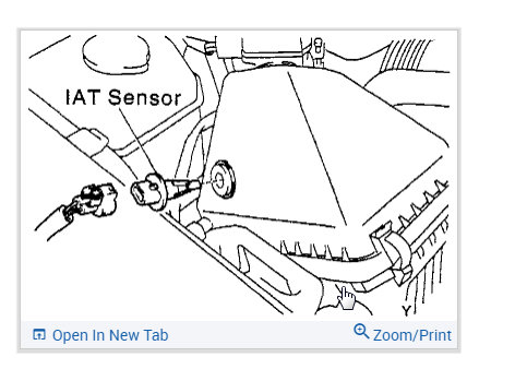

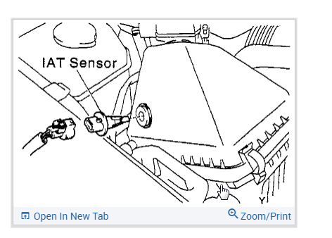

JENNIFER OLSON
Hi, I have this problem with my 96 tacoma. It is a manual so if I can give a push and pop the clutch that gives it a spark to start. But otherwise I just have to let it cool down before it will start again.
Tuesday, July 23rd, 2019 AT 7:45 PM

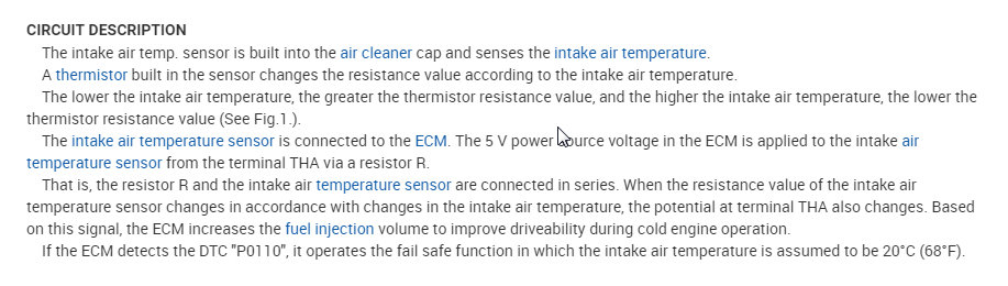

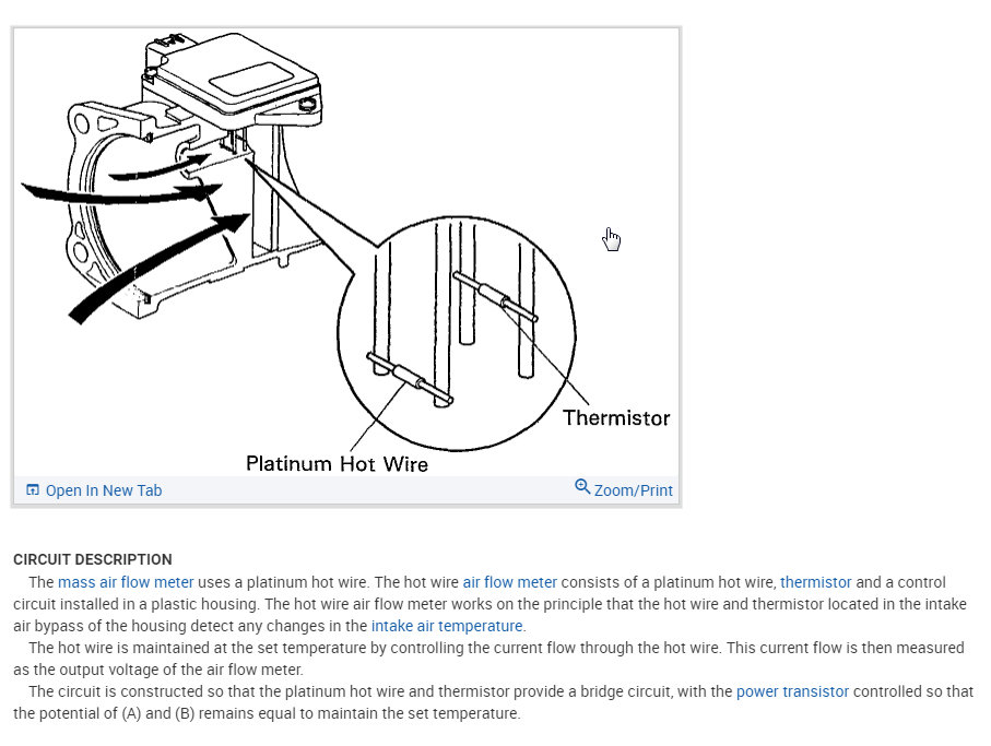

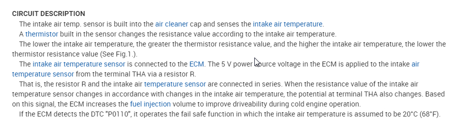

Hi Jennifer,
More than likely this is a dirty sensor. Try unplugging the intake air temp sensor and see if it starts. If it does then I would clean this sensor and the connectors. Since you are there, I would suggest cleaning the air flow meter as well.
These sensors are used to determine the proper amount of fuel to inject. If they are not reading properly then it will not supply enough or too much fuel and won't start. It may be worth while that when it is doing this to go ahead and pull a couple plugs and see if they are fuel soaked.
Here is a link on how to clean the sensor.
https://www.2carpros.com/articles/mass-air-flow-service
