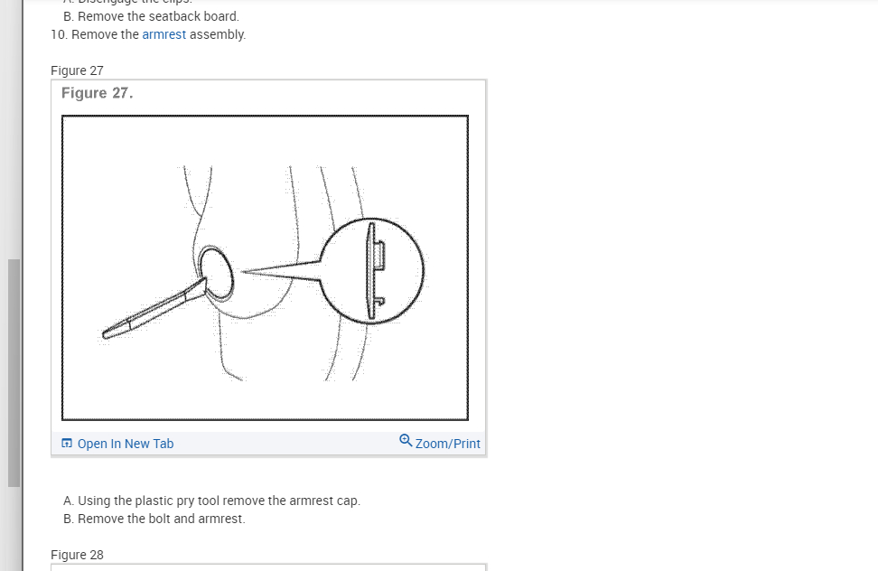

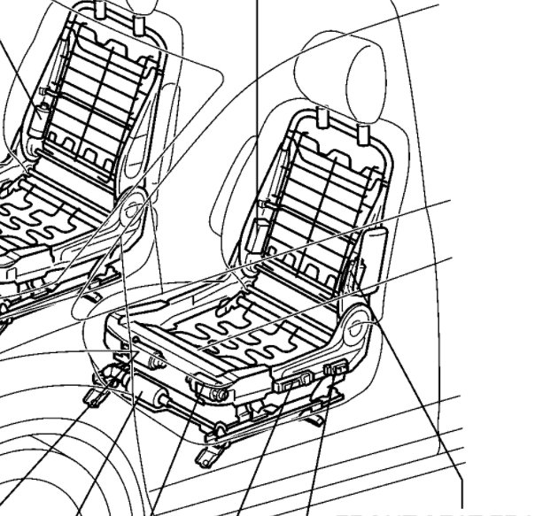

I'm just wondering if there's a way to fix the arm on a driver's side chair or if the whole chair would just have to be replaced. My children did something to it and it now is loose in its socket. In other words, it won't stay in place to use as a arm rest, instead it just falls down.
May 19, 2010 at 2:18 PM
The most likely cause of this is the bolt that holds the arm rest in place has come loose and needs to be tightened.
There are a couple of different styles of this. If you have a zipper on the arm rest cover then you just unzip that, and the bolt will be accessed that way.
If not, then you will have a plastic cover that covers the bolt. Clearly this is the easiest way so hopefully you have this style.
Please see the attached info below and we can answer questions that you have about this.
If you have a different style, please get some pictures of what your arm rest looks like, and we can go from there.
