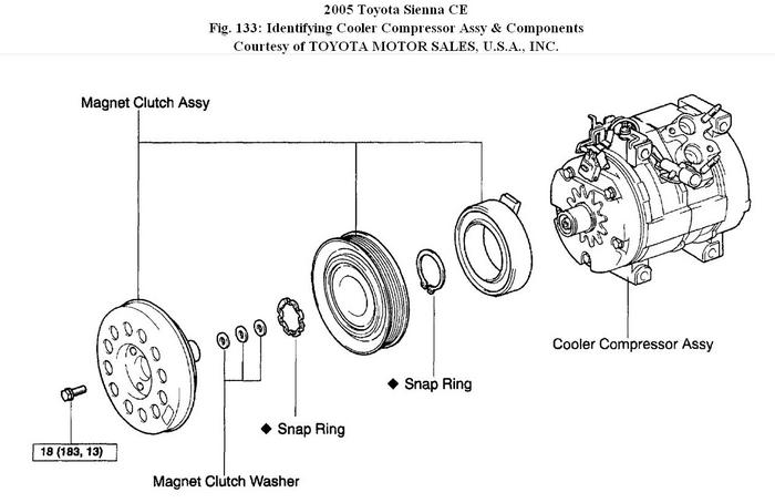

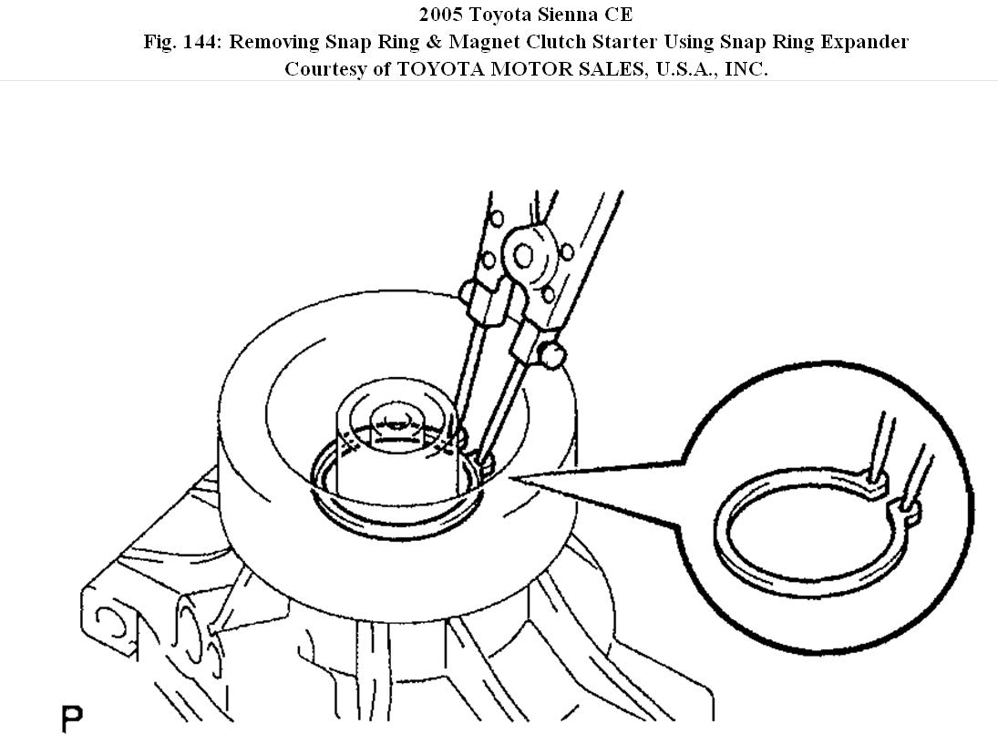

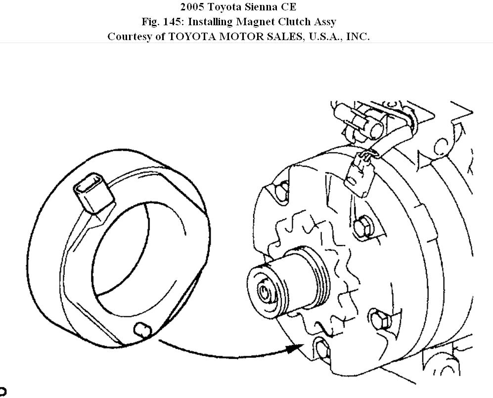

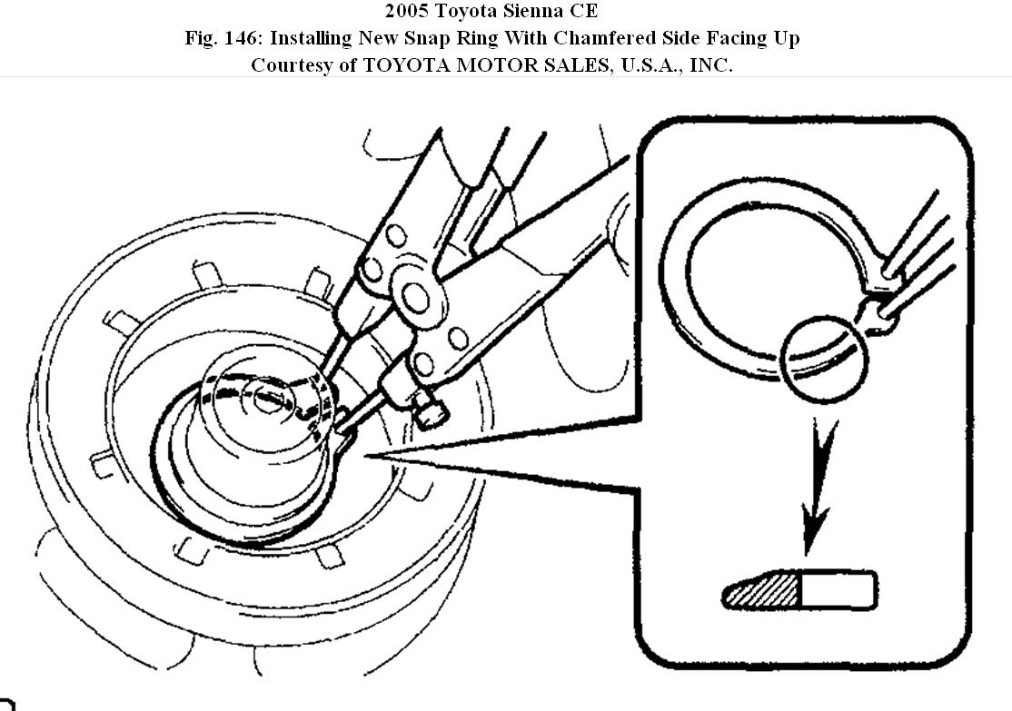

It is not as simple as that but neither is it too difficult.
REMOVE MAGNET CLUTCH ASSY

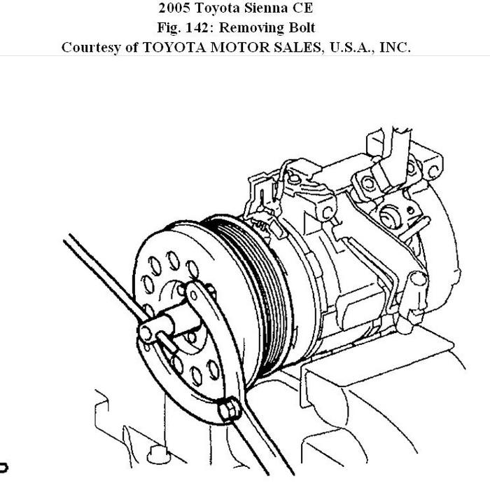

a) Place the compressor and magnetic clutch in a vise.
b) Remove the bolt, the magnet clutch hub and the magnet clutch washer.

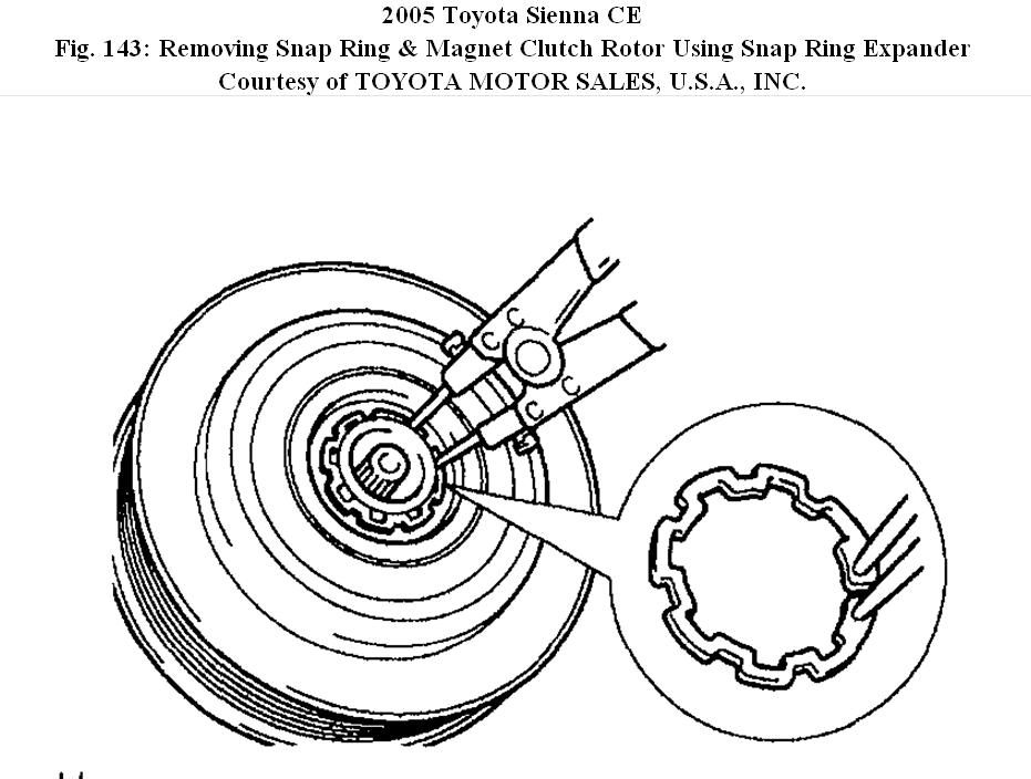

c) Using a snap ring expander, remove the snap ring and the magnet clutch rotor.
d) Remove the screw and disconnect the connector.

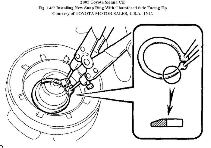

e) Using a snap ring expander, remove the snap ring and the magnet clutch starter.
INSTALL MAGNET CLUTCH ASSY
a) Fit the parts as shown in Fig. 145 and install the magnet clutch starter.
b) Using a snap ring expander, install a new snap ring with the chamfered side facing up.
c) Install the screw and connect the connector.

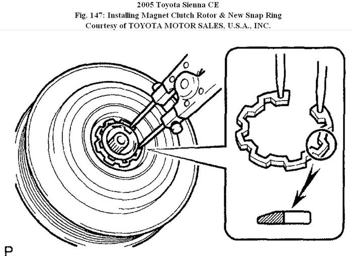

d) Using a snap ring expander, install the magnet clutch rotor and a new snap ring with the chamfered side facing up.
e) Install the magnet clutch washer and the magnet clutch hub.
NOTE: Do not change the combination of the magnet clutch washers used before disassembly.

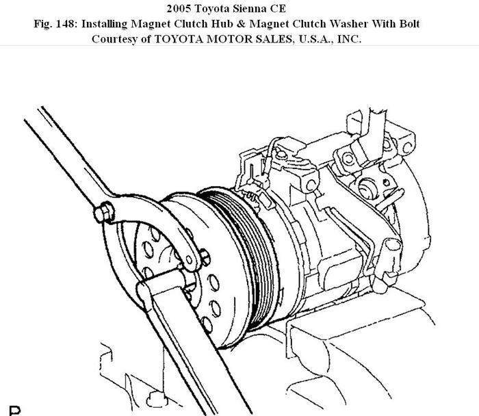

f) Install the magnet clutch hub and the magnet clutch washer
with the bolt.
Torque: 18 N.m (183 kgf.cm, 13 ft.lbf)
