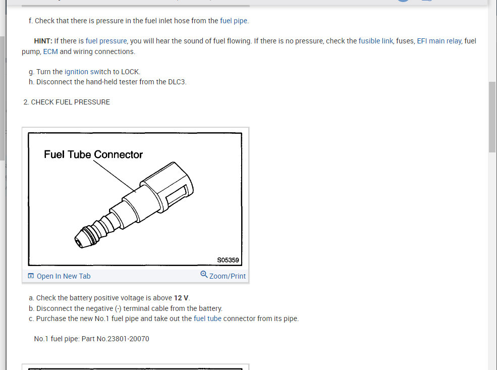

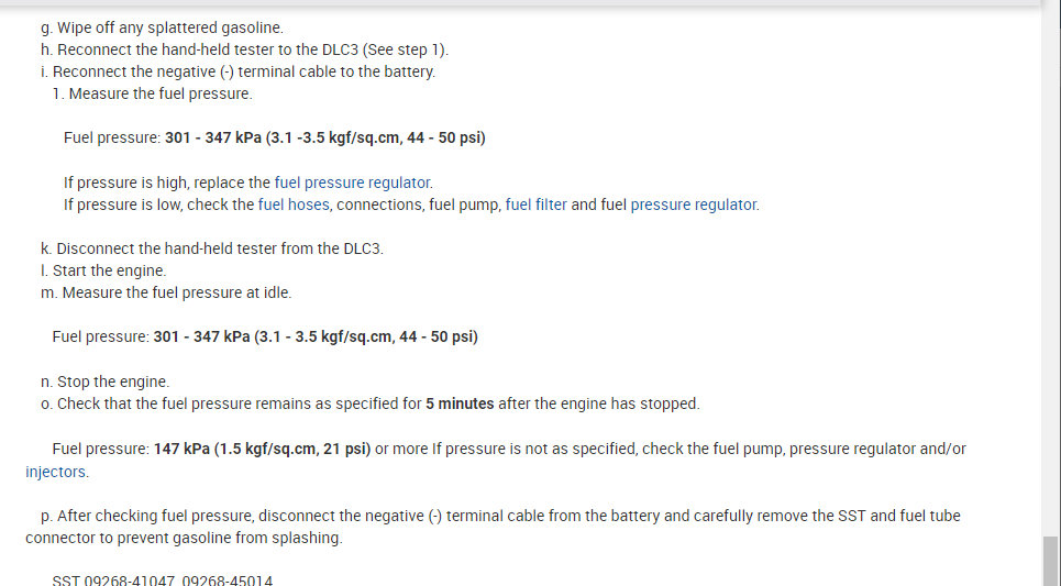

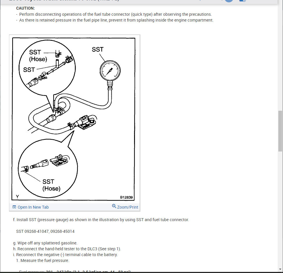

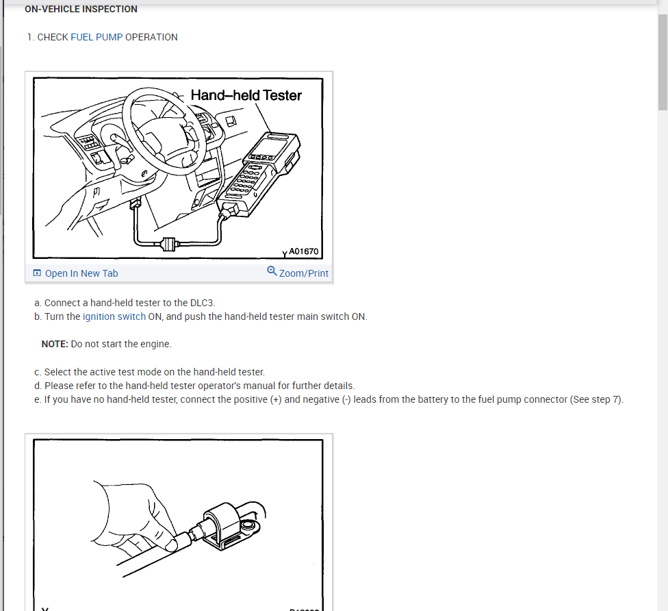

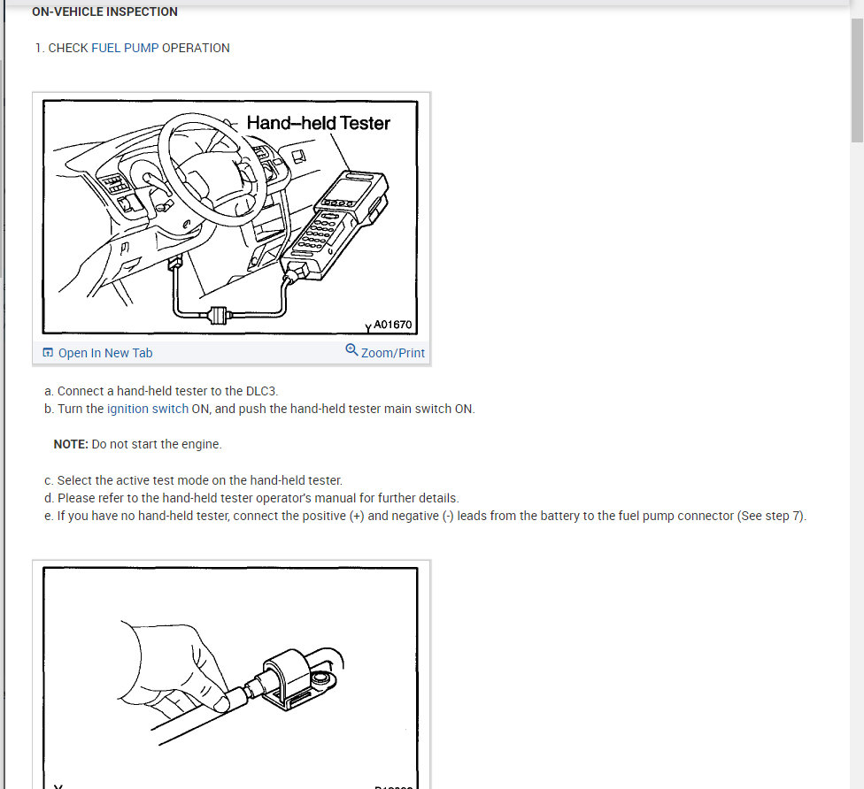

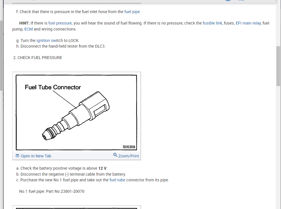

I would suggest we start with checking the fuel pressure from this guide. Here is a guide specific to this task:
Below you will find the process from the manual on how to do this test. Please let us know what you find and we can go from there. Thanks
