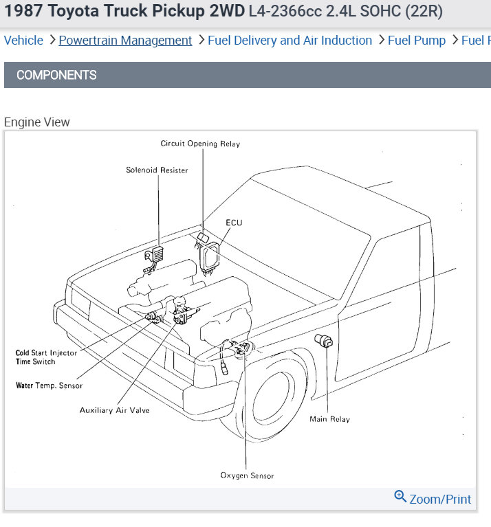

I turned the truck off and when I went to start it, it would turn over but no start. Replaces the fuel pump but when I turn the key on the pump will not run. I jumped the wires to the pump and it pumps like crazy.
22re 120,000 miles.
If this has a fuel pump solenoid I cannot find it anywhere.

Check the EFI fuse, EFI relay, circuit opening relay these go out all the time. Here is a guide and the location below so you can test for the issue:
Cheers
Thursday, October 11th, 2007 AT 11:02 PM
DEARHUNT05
Yep, great guide. I tested the relay and it was bad truck started right up with the new relay. I love this site.

The COR powers the fuel pump and MAF sensor grounds it to complete the fuel pump circuit.
EFI circuit opening relay behind right kick panel, above the ECU.
Why are you chasing it-is it no power to the fuel pump connector. Do you hear the pump come on when key at on position.
