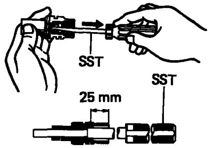

My speedometer works fine, no jumping around, seems pretty accurate on speed.
I starts howling about 45mph and gets worse as speed increases. Toyota parts guy says it doesn't have a cable so do I need a whole new thing or can it just be lubricated?
Thanks

Yours is cable driven-Inspect the speedo gear and oil seal SPEEDOMETER GEAR OIL SEAL REPLACEMENT (2WD)
https://images.2carpros.com/forum/automotive_pictures/12900_speedometer_cable_1.jpg
(a) Using SST, remove the oil seal. SST 09921-00010 (b) Using SST, install a new oil seal. SST 09201-60011 Oil seal depth: 25 mm (0.98 in.)

Why would the parts dept at the Toyota dealer tell me it has no cable, just has a sensor?
It is a 1994 Toyota pickup. 2WD, manual trans, 4 cyl. 22RE.
