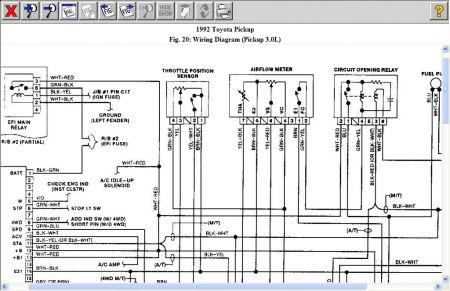

Very frustrated. Problem started with starting truck up, would run for a few seconds and stall out. Replaced fuel filter, with no change. Replaced fuel pump next. With the ignition key on, there is 12 - 14 volts going to the fuel pump harness. Disconnected harness, connected volt meter, as soon as starter turns engine over, the voltage goes to zero. I took my battery jump box, and connected to the pump harness direct to verify operation. Pump operates. After doing this, I reconnected the harness and turned engine over, it will run long enough to burn the gas injected by me operating the pump, then stalls out. I've checked the EFI main relay to verify it"s operation, checks ok. I have no idea why I'm losing the voltage once the starter engages. I would greatly appreciate any help on this. I've spent a ton of time trying to troubleshoot this. Thanks to anyone who may have seen something similar, and can help me. If you would prefer to call, my # is 508-735-0932.

Try blocking the airflow meter flap wide open and attempt to start and tell me what happened

Do you see something like this Test the meter and also the circuit opening relay and the EFI relay

I did what you suggested once I got the voltage back in the supply harness. I opened the air flow meter flap, and held it open with a screwdriver. The truck fired up. I let it run for a minute. As soon as I touched the accelerator, it died out. I tried repeating the process, and have not been able to get it started again. Based on this, what does it mean? Is there something else I have to do? (other tests), or does the air flow meter need to be replaced?

Test the airflow meter using the repair manual procedures before you condemn it.

I checked the resistance in the repair manual, and it all checked out ok. Now I really have no idea which way to go with this. I was actually surprised that opening the flap actually made the truck start up, prior to this, I didn't even know what an air flow meter was. The meter tested ok, so now what?

The Fc terminal of the meter grounds the circuit opening relay-Check and test the COR The EFI fuse powers EFI relay than powers the COR Do this find the diagnostic check connector and jumper the Fp to Batt-the fuel pump sholud come on it bypasses the relays turn igniton On.
https://images.2carpros.com/forum/automotive_pictures/12900_EFI_and_COR_fuel_pump_circuit_1.jpg
https://images.2carpros.com/forum/automotive_pictures/12900_EFI_1.jpg

I just wanted to say THANKS! It turned out to be the circuit opening relay. I just got back from Toyota, put the new one in, and it fired right up. I really appreciate your time and effort on this. I will recommend this site to everyone I know, and you will be getting back extremely positive feedback. Thanks again, Have a great weekend.
