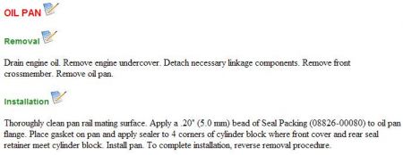

can I remove the oil pan towards the rear of the vehicle or do I need to remove he steering linkage and take it out the front? (or pull the pan over the linkage). If I need to remove the linkage, what is the best way and best joint to remove?

you will need to detach some of the linkage
https://www.2carpros.com/forum/automotive_pictures/261618_Noname_845.jpg
what model is this and is it petrol or diesel?
