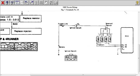

THE TRUCK WONT START. REPLACED MAIN RELAY FOR FUEL PUMP AND INJECTORS. TESTED ALL ELECTRICAL INCLUDING OHM READINGS FOR INJECTORS, COIL, MAIN OPEN RELAY, AND SO ON. CHECKED FUEL PUMP FOR OPERATION AND PRESSURE. THATS GOOD. IT WILL START AND RUN OFF OF ETHOR BUT IT SEEMS THAT MY INJECTORS ARENT OPENING. THE ONLY THING I CAN THINK OF IS THE COMPUTER. SOMEONE HAD MENTIONED POSSIBLY MY DISTRIBUTOR? DOES THAT SEND A SIGNAL TO THE INJECTORS WHEN TO OPEN? SOMEONE PLEASE HELP!

Could be an open wire between the ignition switch and solenoid resistor, the solenoid resistor itself or the grounding circuit of circuit 10/20 drivers on the computer
https://www.2carpros.com/forum/automotive_pictures/12900_injector_5.jpg

How would I test those 2 wires or ck them? Are they tested in ohms or are they a source of power?

One of the injector harness wire should have battery voltage at all times when key is turn to run position-

Are you talken bout one of the #10 or #20 wires? I can ck for a power source into the rectifier harness then right?

Sorry not rectifier but resistor. Rthanks

I'm taking about the injector connector/harness-
