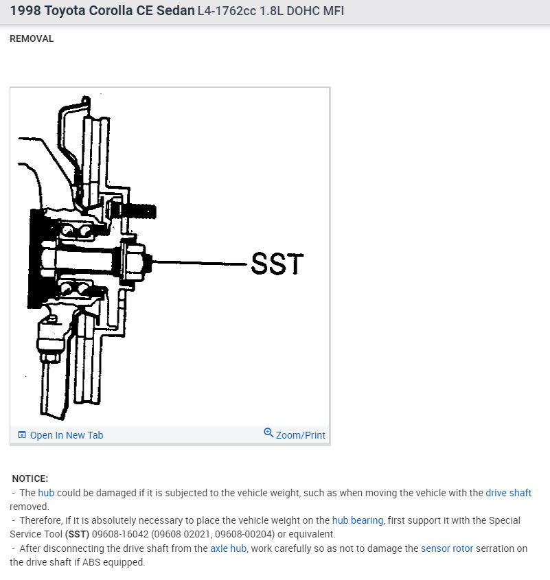

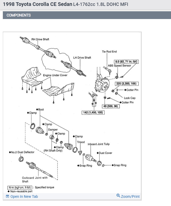

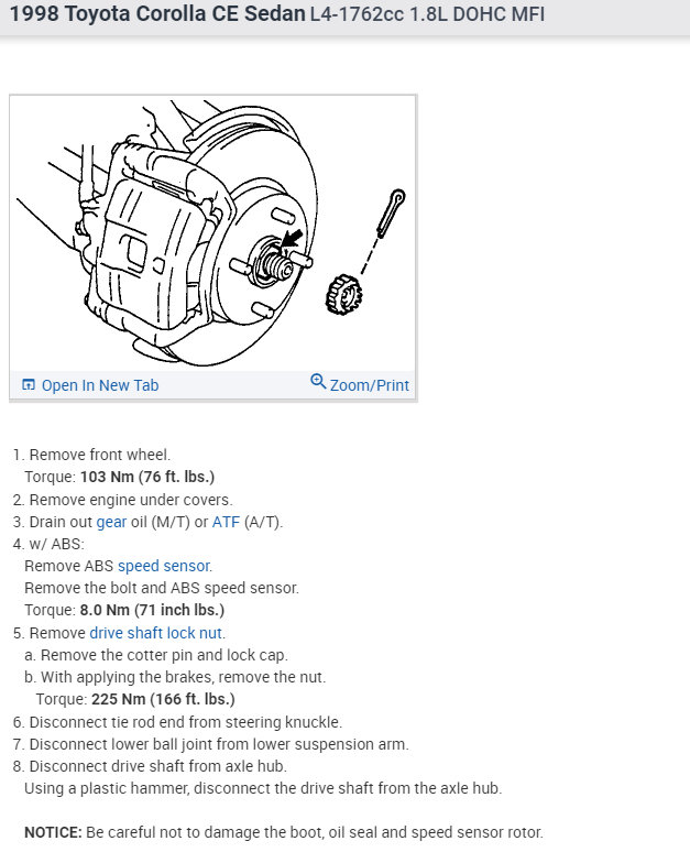

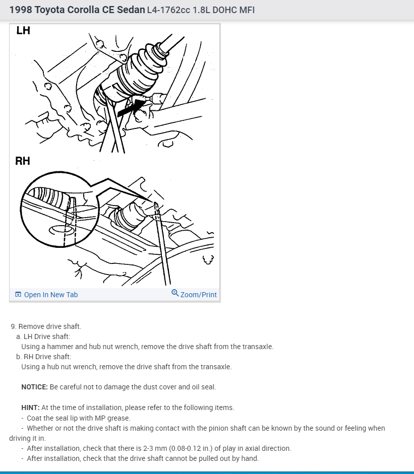

Toyota, Corolla, 1998, 100,000 How do you remove the inner end of cv axle?
Mar 26, 2006 at 5:57 AM
SQM
  • 6,383 POSTS
After removal of the hub and other components the CV axle will come out at you pull on it. Sometimes you will have to use a pry bar to slowly work it out.
Here is a helpful guide:
https://www.2carpros.com/articles/replace-cv-axle
I have attached diagrams of replacement procedure for your reference.
Jan 14, 2022 at 6:00 AM
Suggested Repair
After the hub and related components are removed, pull the CV axle out. If it does not release, carefully work it free with a pry bar.
