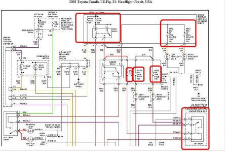

The low beam headlights and daytime running lights went out on my corolla I have replaced the bulbs and fuses and they still do not work. All of the rest of the lights on the car are functioning including high beams. What could likely be causing such an issue.

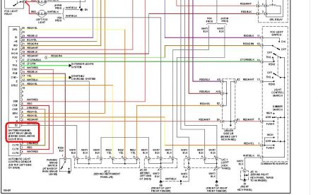

Need you to check all these. Engine junction box- left side 1. Dome fuse 15A 2. Main fuse 40A 3. Headlamp fuses (L and R) 10A 4. DRL fuse 7.5A 5. L/Beam headlight fuses (L and R) 10A Engine room relay box - radiator support 6. DRL relay Behind dash, above glove box 7. Main DRL relay
