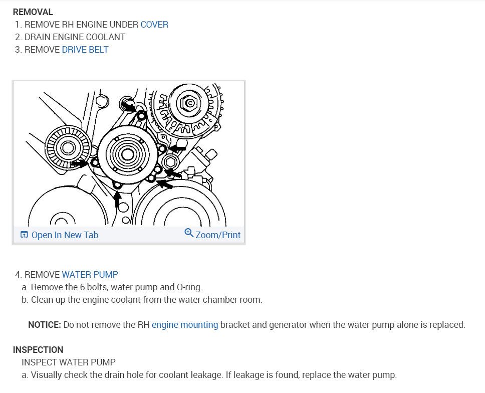

Hi there,
I'm a learner driver and only just recently got my car off a family friend just to learn to drive in. It has done alot of mileage but it was just a car to get me kick started.
The only problem one day it over heated and I need to replace the water pump. I've tried but being new to this I think I just made a mess.
I was wondering if I could get a step by step guide how to take it off and replace it?
Diagrams would be helpful because most of it looks the same to me.
Cheers

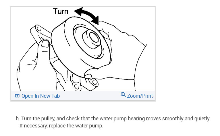

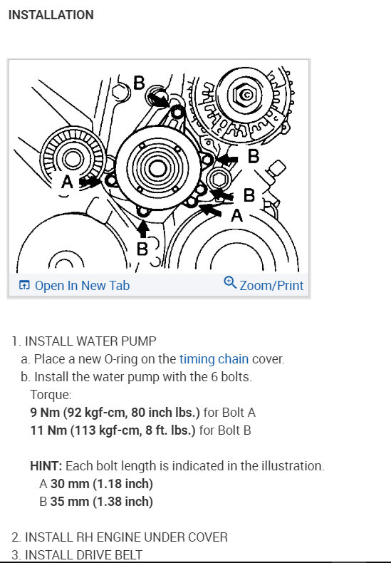

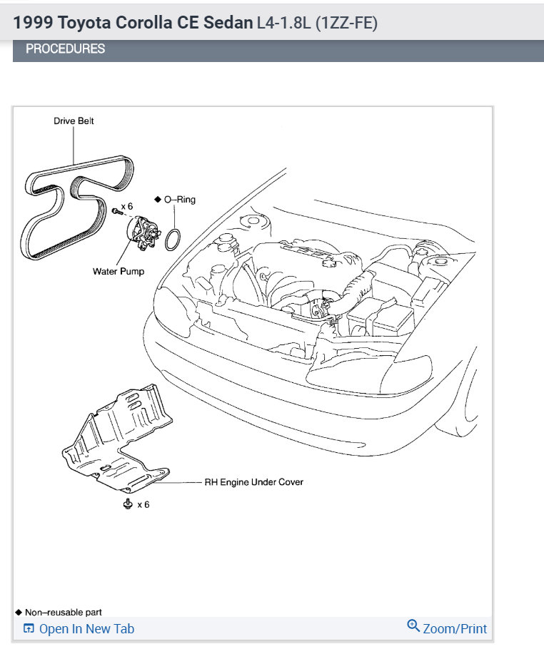

Hello, Here is the instruction on how to change out the water pump on your car in the diagrams below. Check out the diagrams (Below). Please let us know if you need anything else to get the problem fixed.
