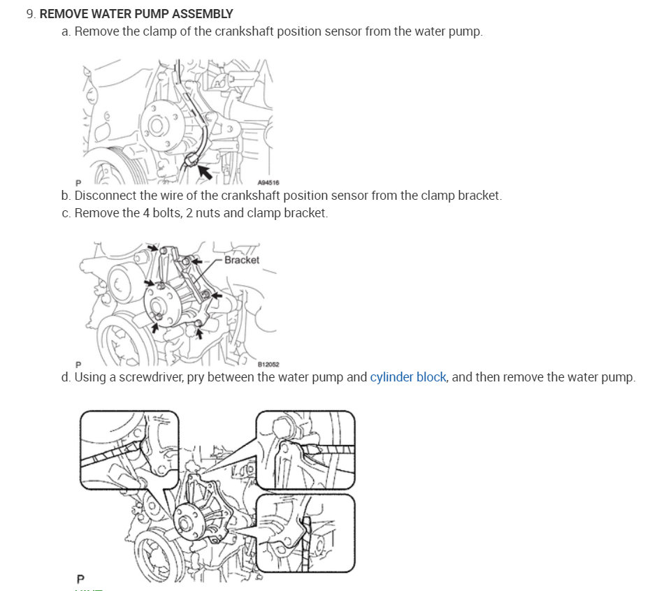

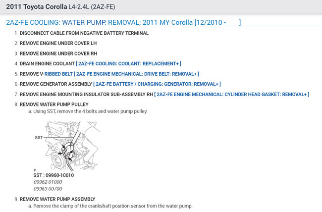

I'm looking for a car and found a 2011 Toyota Corolla but it is salvage it was crashed and the bumper,lights,hood,and I need to change out the water pump? Please reply

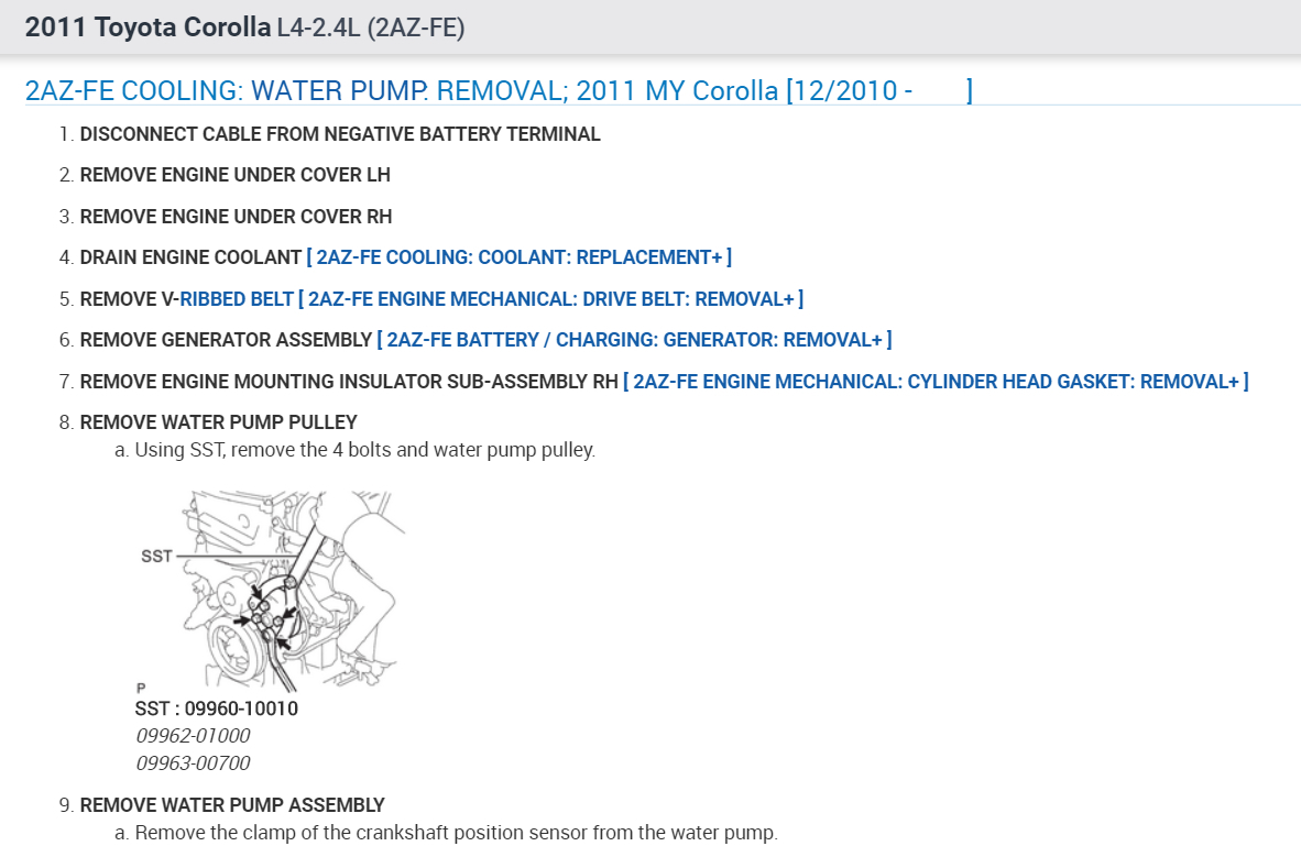

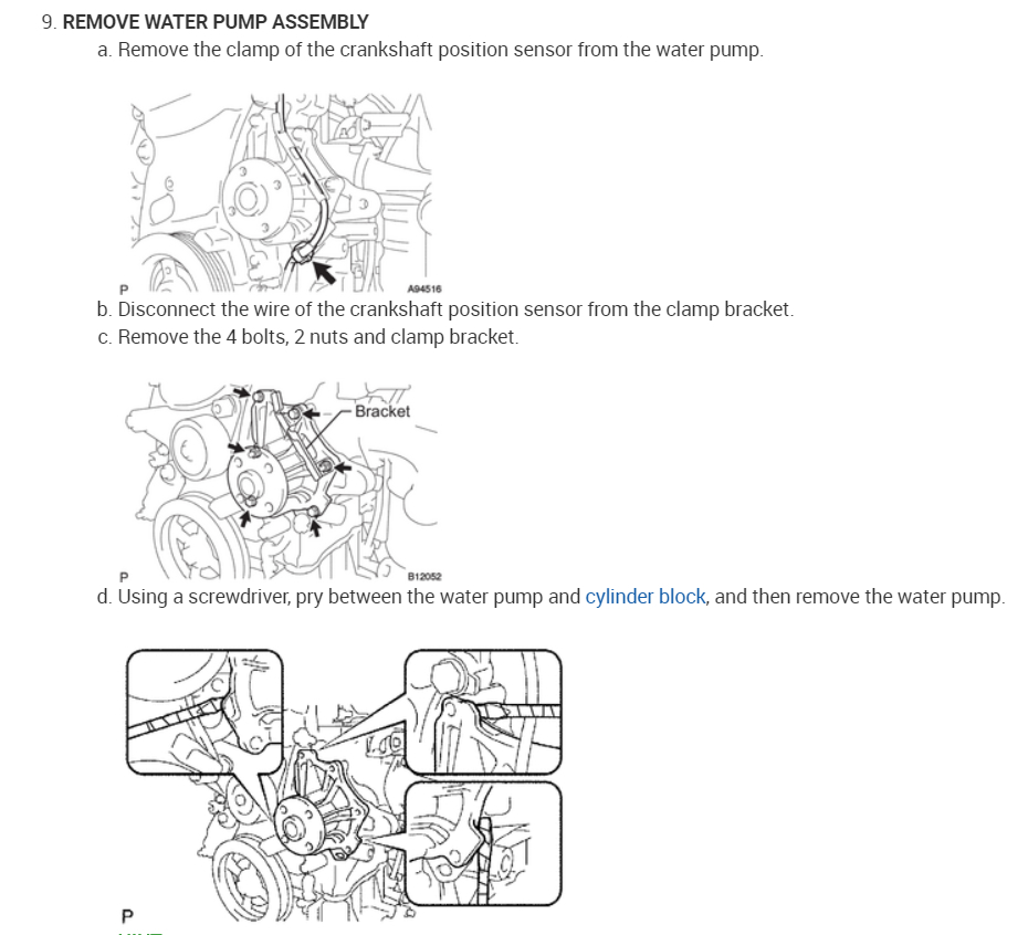

Hello, Here are the instructions on how to change out the water pump in the diagrams below. Check out the diagrams (Below). Please let us know if you need anything else to get the problem fixed.
