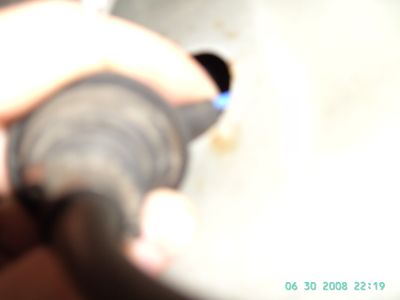

I am replacing an O2 Sensor (the one right before the cat) in my 97' Corolla. I can remove the sensor from the car fine but I cannot get to the connector/plug that the sensor connects to. I have included a picture to give you an idea of what I'm talking about. It seems like the sensor goes into the body of the car and disappears where nobody can get to. Thanks for all your help. If you can email me your solution or another way to find out more info it would be best to email me at nickisjobless@yahoo.com. If not any reply is appreciated.

Does it go into a rubber grommet type deal? Pull out the grommet and pull donw the connector.

I pulled out the grommet type plug and I am still unable to pull out or reach a connector. I have supplied a picture to show you the most I can pull out. There doesn't seem to be a connector in sight. To tell you the truth I don't think there is a connector. Would it be a bad thing to just cut the wire near the sensor and rewire the new sensor to the old cut wiring? Thanks for all your help.

NEVER try to cut and join the sensor wires.
The coupler should be further up. The floor carpet is hindering the movement. Use a screw driver to push the carpet up and you should be able to get the coupler out. Take care not to poke a hole in the carpet.

I did what you said and lifted up the carpeting, measured how far the connector was, and luckily it was easy to get to. I don't know why you said never try to cut and join the sensor wires because that's what I had to do in order to replace my sensor (the new sensor didn't have a connector). It seems to be working fine for now.
