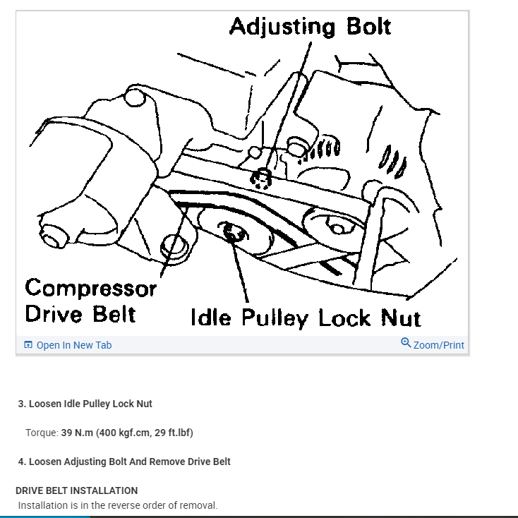

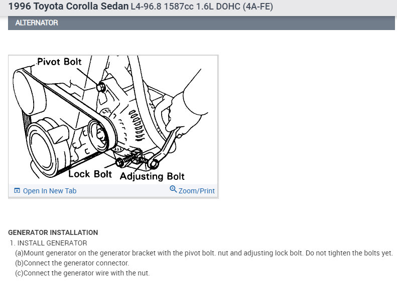

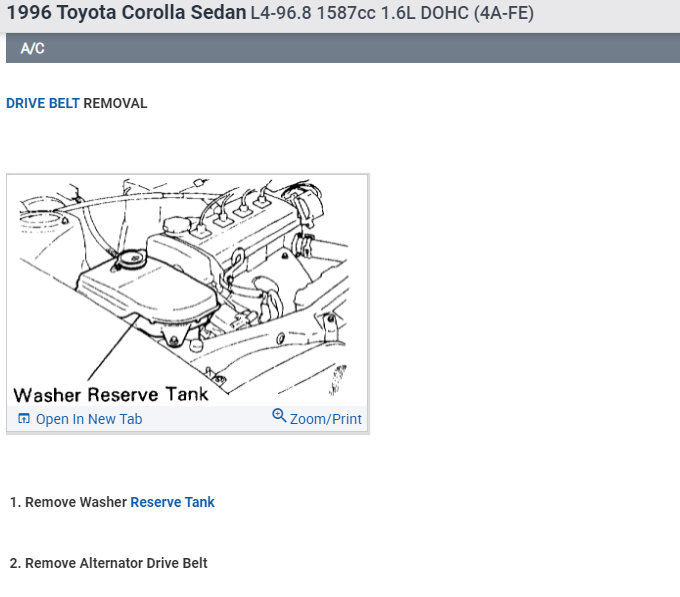

I need to know how to loosen to replace serpentine belt?
Friday, August 15th, 2008 AT 1:50 PM
SQM
  • 6,383 POSTS

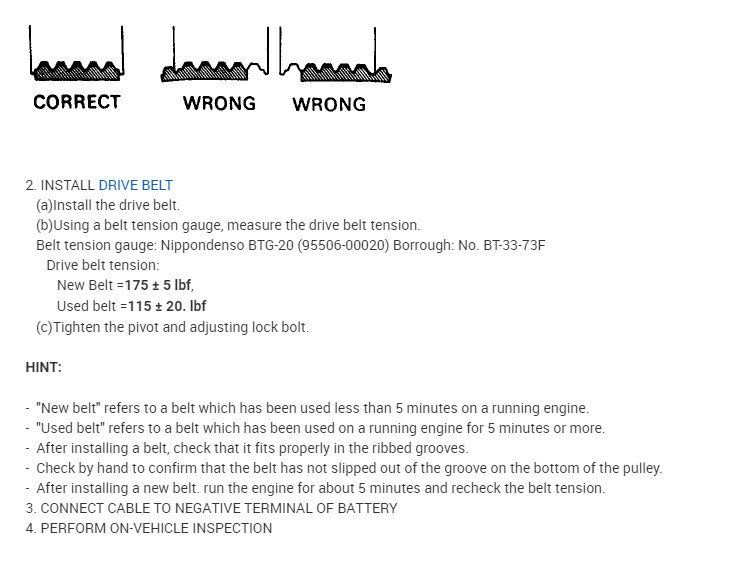

On this vehicle both of the belts are tightened or loosened by adjusting bolts.
Those bolts move in and out to provide proper tension.
I have attached diagrams for both the A/C and the alternator belt below.
