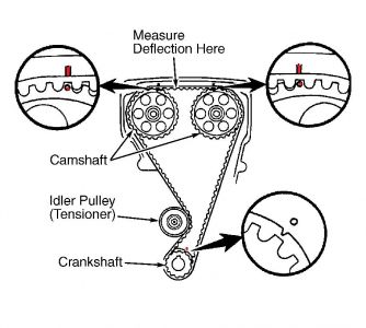

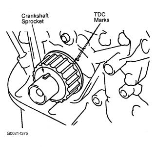

What is the timing marks for the twin cam 5af engine. Can you show me the top dead center mark, it is quite confusing. What is the recomended timing for a stock engine.

CSBORTHOS
5af drives 2 cams just like the 4af. However, im quite confused on how to set those cams since the timing marks are quite vague similar to 4af. Can you show it to me with illustrations. Thanks

Best thing to do is use the car repair manual link in this thread or get a Haynes manual.
The two marks on the inside of the cams are installation marks, the marks on the outside (facing passengers side) are timing marks.
You would use a wrench to rotate the cams to align the timing marks, make sure crank mark is aligned, then install belt.

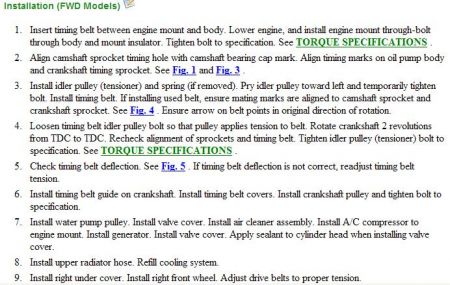

I need to know how to set the timing marks so I can put the belt back on it. When I got the the belt was off of it. It has the 1.6 in it

Here are directions:
http://www.autozone.com/autozone/repairguides/Toyota-Corolla-1970-1987-Repair-Guide/ENGINE-MECHANICAL/Timing-Belt/_/P-0900c1528004fc45

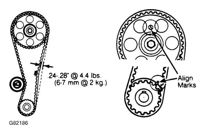

MARTIN ROSA
  • 1986 TOYOTA COROLLA
Four cylinder two wheel drive manual 100,000 miles.
Need to know how to put on timing belt on a 1.6 liter single cam engine.

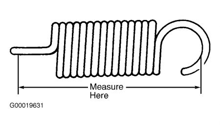

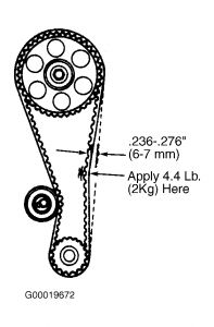

Hi there, timing belt information.
Mark (mhpautos)
